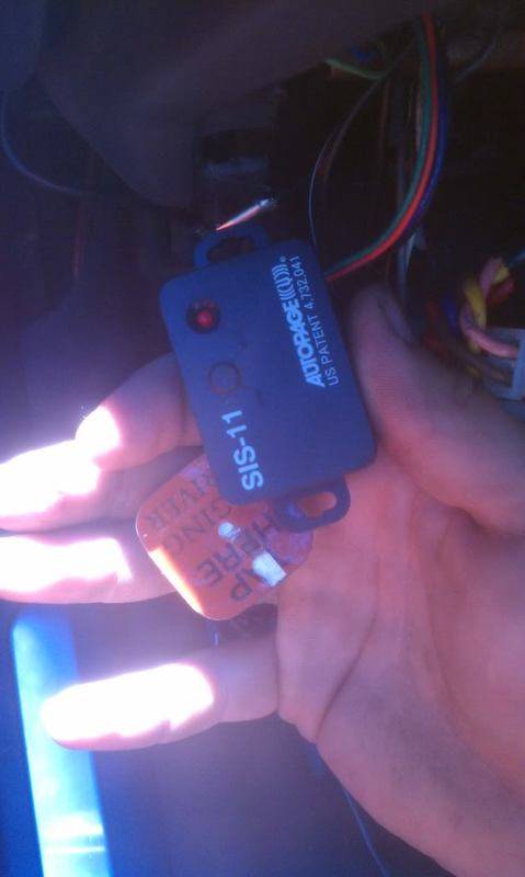

So i was dyno-matting my car and saw a couple wires coming through the bottom of my steering wheel area. upon further investigation i have found
1 autopage modual of some kind?
2 what appears to be an antenna
3 a meter of some kind?
all of this was less than professionally installed....is this something i can take out or is my car linked to the security on this thing? everrything was just kinda sitting in there and idk how i like riding around knowing i got all this crap behind my dash.....
a few pictures....
the little red light on that piece kept blinking in weird patterns....
so maybe thats why my car had a speaker when i first got it?

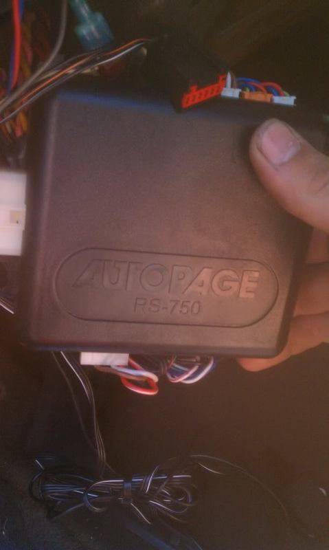

picture one = main brain of remote start with alarm system
http://mycoolmustang.homestead.com/rs750.html
picture two = dual stage shock sensor
http://www.autopageusa.com/t_inside...5&prodID=129f6b7a-2347-4e1a-a926-a63a5174c694

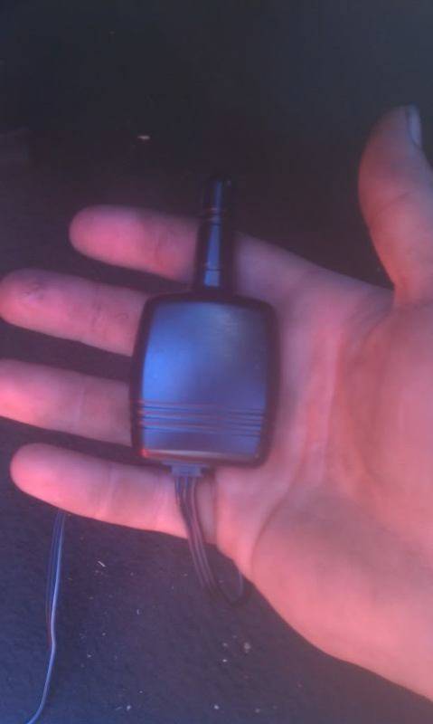

picture three = two way antenna for system
if it was installed correctly, the system would have the cars starter wire cut (for anti grind, and starter kill to make it harder to hot wire) so you wouldn't be able to just unplug it.
there should also be a bypass module if the remote start portion was ever hooked up, this may be a little black box with a key hidden inside of it.
If this is the case you may want them to order new aftermarket key fobs for you and get the system up and running since it seems you have all the components. It looks like on if those systems with a LCD screen on it. It may cost you the same to get it active instead of removed
