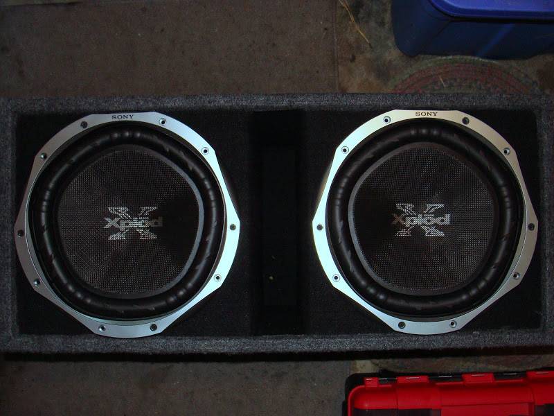

I was at Best Buy yesterday looking for DVDs, and came upon this open item in the car audio department - two Sony XS-L126P5 12" subs mounted in a center ported enclosure for $69 bucks. :eek:
I had to bring it home with me, just because. :)
I have wanted a sub for the longest time, but it always got pushed aside for other things. I just want a little bump, not to compete or anything like that. I think this thing will fit in the trunk. The box is 14.5"h x 32"w. The Mark is at Aric's now, so I have no idea what the measurement is for the space in the trunk, but I thought I have read that people are able to fit 2 12's in the space.

Here's the sub's:
well for starters id put all the screws in. the subs are rated 380w rms and 1300w peak @ 4ohms. rms is like your "idle" wattage and we all know what peak is, so try and find some amp thats close to that. dunno too much about kicker anymore (im rocking mtx equipment from the late 80's lol so im a lil out of the loop) im sure laser or nolimit will be able to shed more light on this for you
Way to Much power. The speakers run at 4 ohms and are single voice coil, the amp runs at two oms, which means you would have to bridge single voice coil speakers, which makes it easier to destroy (blow) the speakers. Go for an amp that has a rating of 400 watts at 4 ohms or 200 watts at 2 ohms. Your are 380watts a piece, so you want an amp that gives off about the same or less.
