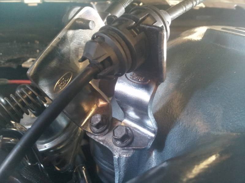

Since I use a Cobra fuel rail, I cut 2 of the mounting tabs off my Mark rail and cut what I needed off the throttle/cruise bracket and welded it together. Now my cable brackets have Ford stamps ;)

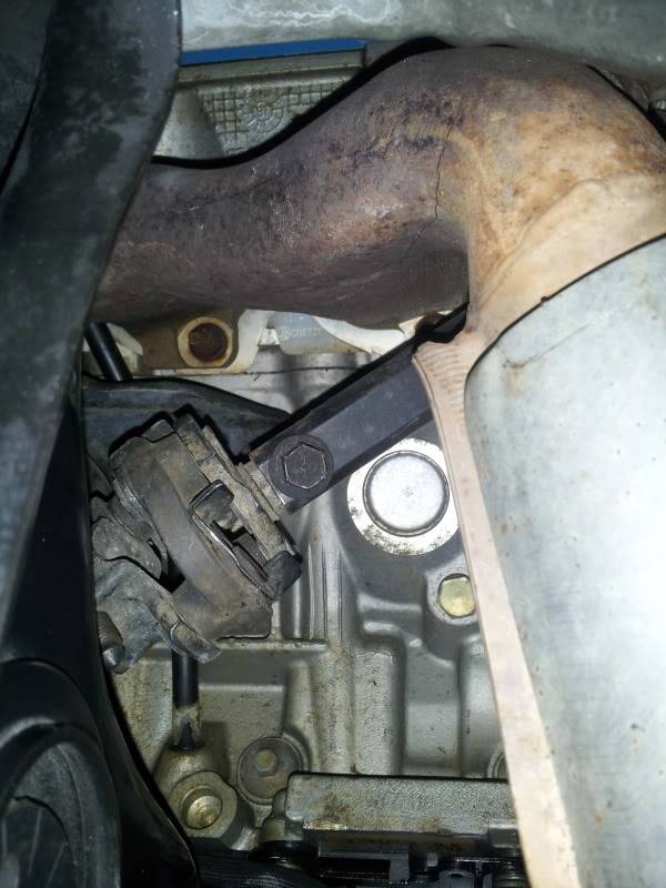

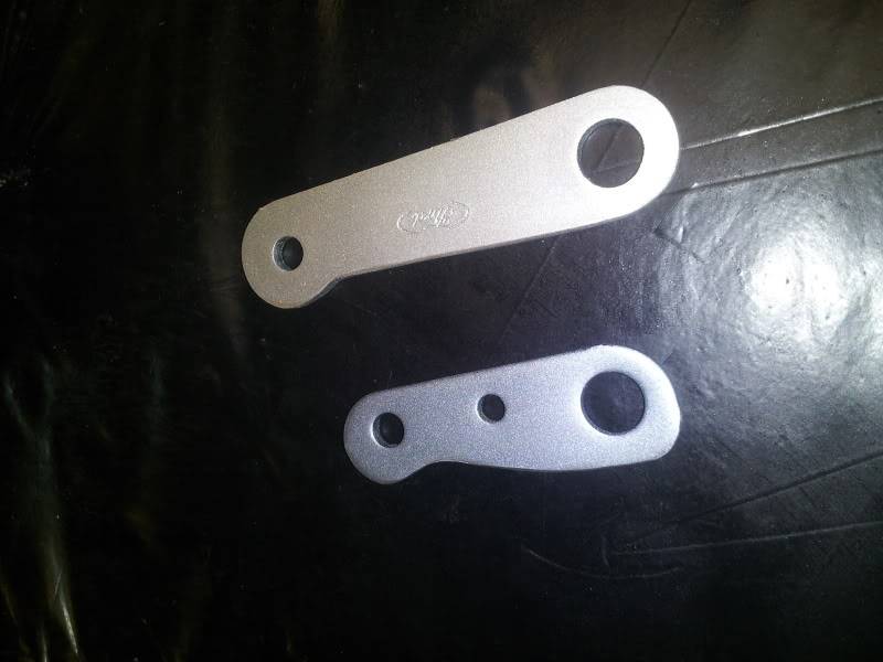

Upper brackets for Alternator, COP doesn't need the wire bridge over the Alt so I cleaned that up

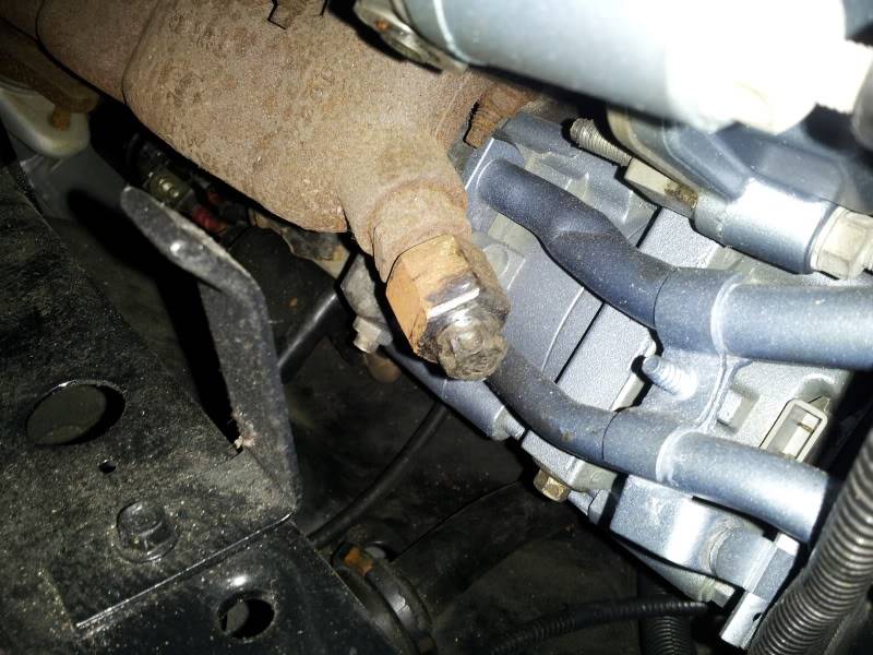

EGR delete, just cut the EGR pipe and remove the fitting, shear a bolt head off a bolt and weld it to the fitting.

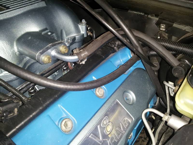

EGR plate, use an old piece of EGR pipe and make a little fitting for the brake booster

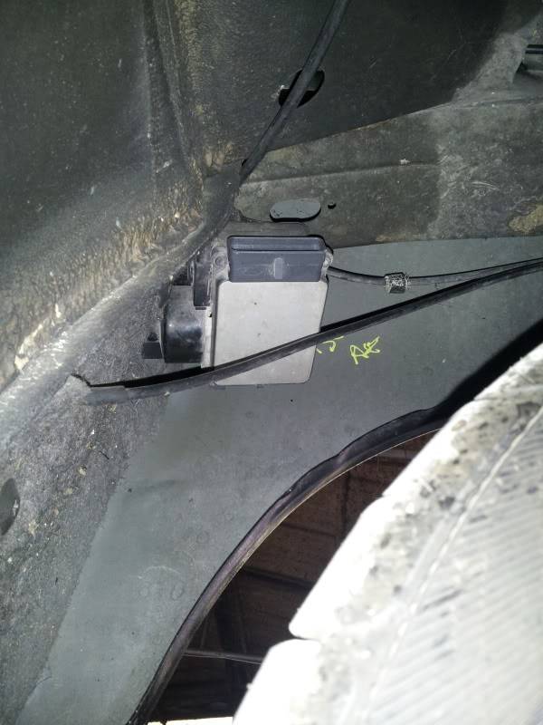

I'm using stock MarkVIII throttle and cruise cables. You'll need to relocate the cruise module to behind the wheel. There's already a hole to run the cable thru the wheel well (the same hole that people think is the access hole to remove the rear nut for the UCA)

Had to relocate the cruise module, haven't made the extension for the harness yet

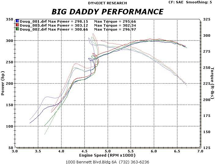

Damn i need some mph. Was racing a good friend in a stock auto 3v. Got him through 1st and the first part of second. But in the big part of second and into third he started motoring by. So the intake is needed badly
Its only worth 2-3 HP
From a financial aspect, I think you'd be better off sneaking in a 50-shot
Maybe for first Gen cars. I can't argue with results kirk and Doug have have after the switch
Hmm.. mine sure seems to dig a lot more now.. lol,
Doug , what kinda power difference did you discover with your swap? Mine hits the dyno in a month
Moss, I don't want to burst your bubble but full exhaust with headers and tuning is key with making the Cobra intake produce results like Doug and I have. Consider the other boltons we have just icing on the cake. Also, shift high tough guy. 6500 rpms is still shortshifting with the Cobra intake IMO. It will be worth decent power if you open up your exhaust all the way to the block.
+1
If you're going to take more air in, you've gotta be able to get rid of it just as fast
Won't get any arguments out of me. Headers/stall are on the list, just getting there one piece at a time.. sucks being poor
