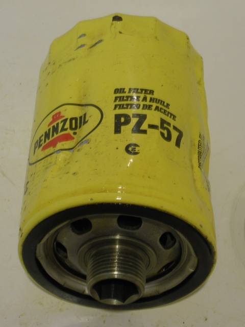

Just a quick one guys. I went to change the oil yesterday and noticed that the oil filter JiffyCrap put on was of a different thread from what is probably normal/every other oil filter. Here's a pic of the filter and so far no one around here can match one up, and at nearly $80 a pop for an oil change with synthetic, I REEEAAALLY do not want to pay someone else to do something that I can, for just about half the price....:confused:
The car is a 2001 LS 3.9 V8.
first off, it looks like that piece in the middle of your filter is supposed to stay on the car (that end sticking out is what you should see on the car after you take the filter off). The filter should have a female thread.
second, i reccomend the purolator filter for better flow, better multi-pass efficiency, and ability to filter smaller particles.
:lol: ....I was JUST thinking the same thing after noticing the octagonal shape of the inside....so thats what happens with oil filter wrenches huh?! Well, now I know to be more gentile! Thanks!
Yes that stub should be in the filter mounting point on the car.
I do not think you caused this problem but the jerk at the shop who over tighten the filter at the last oil change.

good luck putting that piece back in though.... looks like a pita to get out of the old filter without damaging the threads
i dunno, stick that sucker in a vise, find a big enough allen wrench, and go to town!! :shifty:
thats a big allen wrench!!!!!!!!!!!!!!!
and if you put the threaded part in a vise, yo'd likely screw up the threads. MAYBE if you put some wood between the vise teeth and the threads it MIGHT work out so you could wrench on the filter.... but idk
Noooo, don't ever clamp threads in a vise unless you WANT to destroy them. Not even with a wood block in there.

Find a bolt that fits inside it, slap a vice grip on the threads of the bolt and twist!
double up the nuts. find two to fit on there and tighten them to eachother. then use them to back out the piece

seriously - you can buy allen wrenches that size. Axles, truck parts, tractors, ... use them (and apparently so do LSes).

Thanks guys! I DID manage to solve the problem which I've never come across in all the years I've been doing my own oil changes!:
Went to 4 auto shops & Home Depot("You can't do it, and we won't help")...then went to a specialty tool shop I know of ONLY b/c I used to do windows & siding contracting....and it turns out, that a 9/16ths hex-bit WILL get these things off...when you put the WHOLE filter in a vise and use a nice big breaker bar/ 18inch wrench.
It actually came off pretty easy, and I had no damage to the inside. The main issue was getting the filter juuussst tight enough in the vise with out over tightening it for fear of slicing through the filter with the part still attatched.
The total cost? 15$ and some change for the hex-bit.
