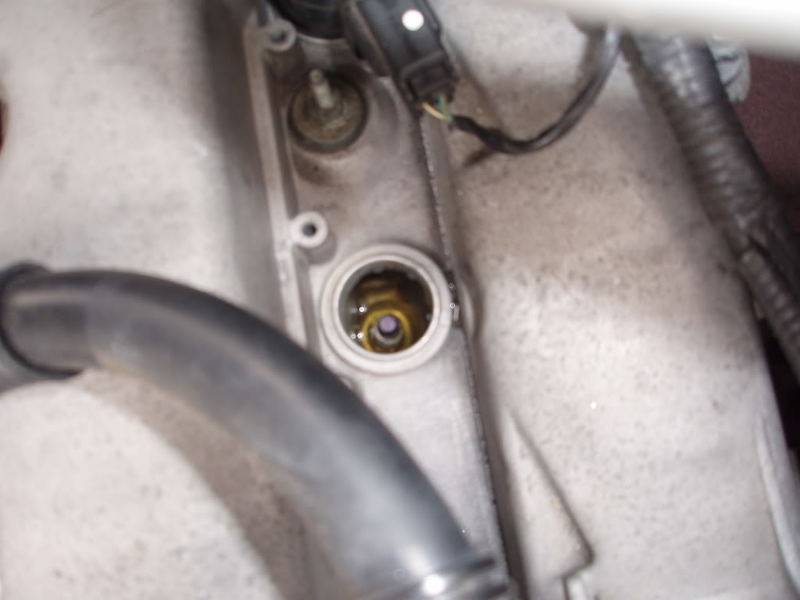

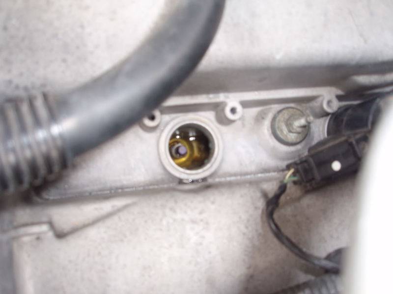

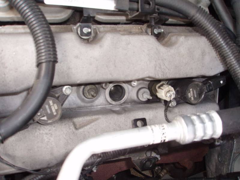

here are some pics
Coolant level is fine, there are no signs of anything leaking, top of the engine is all dry...
Looks like engine oil, not water. (note that 5W20 is quite thin) The fix would be to replace the valve cover gasket sets.
Check you cowl area between the windshield & hood for leaks if you think its water. That's the only place I know that water can leak from. I'd lean more oil than anything though.
