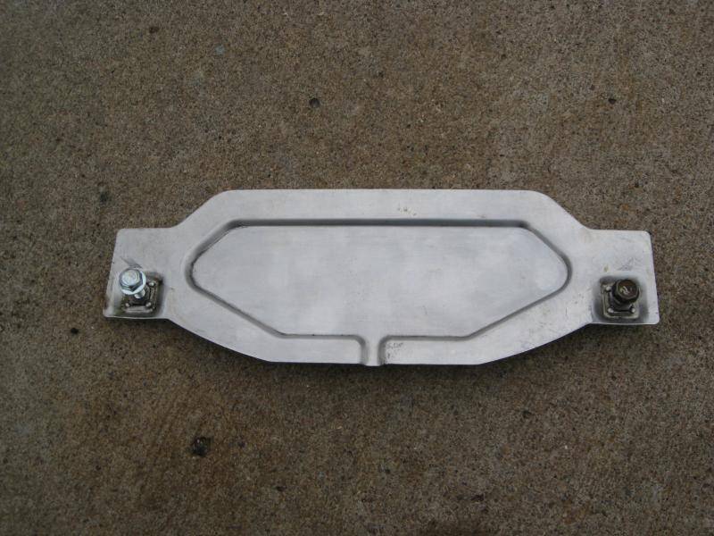

I asked them about checking it out through the inspection plate, and they said my car doesn't have an inspection plate.
WTF?
Is it possible that the 4R70W from a 2002 Mustang doesn't have an inspection plate for this? Or is the shop BSing me?
dang. not again. sheesh.. :)
WTF?
lookie!!! inspection plate. it has to have one. how else would they tighten the torque converter bolts?
