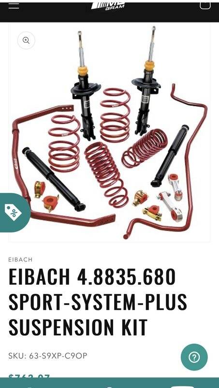

My idea was, since they need replacing and im already considering the alignment idea why not get a suspension kit to kill three bird with one stone. (I want the ls sum lower, suspension needs replacing, would need alignment as well after instal)

2. There is a kit for the Ls i am attaching a screenshot of below. Is this kit worth getting alignment aside. For low applications only. Not performance.
DISCLAIMER:
I was originally going to turning the ls into a clean daily driver. But as lots of little aspects have needed repairs or arnt perfect i think im going to go full project car if this is applicable. Simply going for looks and unique aspects. A crooked subframe with a straight alignment will be ok with me as the car was cheap and im just looking for “cheap” fun with the car and learning more about working on the car.

I won't comment on the suspension upgrade, but the front subframe may be only being held because it has broken bolts in the other 3 holes. I removed my engine and transmission along with the front end and those 4 bolts to the body were pretty rough going on the removal. It would not surprise me if the bolts broke or got sheared off by the impact. If you can figure it out, find out if those bolts are broken, because you'll have a pretty rough time getting them out if they did break, and they go into a blind area where you probably cannot replace the nuts that are built into the body.

sounds good, turns out my shocks arnt blown out as well. I was looking and the tech guy was just being dramatic about the upper wishbone to knuckle bushing being blown and each side. Seems common an these cars. So i wont be considering low anymore. But I cant seem to find just the part for the suspension, so is my best option to just buy all new upper wish bones with pre set bushings? I found a set for $100, not a bad deal.
