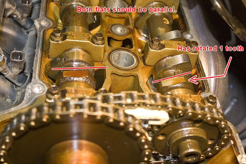

got a 2002 ls sport got the quick fit chains and 4th gen tensioners I thought I had it chain was slightly loose and seemed tensioner was at full length I pulled the caps zip tied the chain on the cam sprocket went to move the cam it wouldn't budge noticed that a lobe of the cam was indexed against a lifter put the caps back on rotated the crank to relax the cam took off the caps and could remove the tensioner turned out a red one like the new one I got the aftermarket one even looks a little cheaper noticed these tensioners are really not that strong of a spring and can be depressed fairly easily …… my cam doesn't appear to have flats for lining up so im being careful but wondering if its the chain itself that gets slack or do they keep adding length to the tensioner :)
… my cam doesn't appear to have flats ...
They most certainly do ...
Yup, they all have 'flats'. You'd not be able to set timing without them.

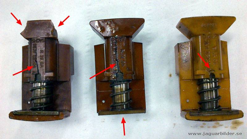

Take notice of the new (white guide) tentioner, see how far it pushes the secondary chain upwards.
Old split, cracked, worn out 1St GEN tentioners fail and thus does not provide the upwards tention to keep the chain in it's position as it should.
The crack/split prevents the little pin on the shaft to stop at the notch-out and at such point the exhaust cam will skip a tooth and out-of time is the result. You don't even want to see the damage of internal valves and such. You'd be looking for a replacement motor at that point.
On these 1st GEN Lincoln LS'es, when the secondary tentioners (and guides) give out, the secondary chain will flop around and you'd hear a 'bag-o-marbles-in-tin-can' noise at idle. It'll be so loose, should you continue to drive it hard and beat on it, it'll simply skip a tooth and end up out of time if your lucky. Worse case scenario, it grenades the entire motor. Lay a good beating on all the valve and mark up the top of the pistons. A huge and expensive job to recover from. Replacement motor would be cheaper and faster.

appreciate that ...but i was in knee deep found out you have to relax the lobes cant remove cam without starting from a relaxed lobe position which seems to be flats are on sides not visible .. ended up having to turn the crank with both covers off to view all cyls with flats parallel with heads when done to make sure ...still not together yet (latin) drivers side pain had to drain it remove the bottle to remove the master cyl to have enough room and is still tight ..noticed slop on secondary it was a red tensioner thought it was plastic wasn't its a newer type like the newer one I bought ...maybe spring in tensioner was too relaxed replaced the tensioner and quick fit chain hope I don't miss any fine tune as with sprocket rout wish me LUk

in reality, being Secondary or Primary, they are both in the oil sump with the same miles on them going through the same constant heat cycling. The tentioners on the Secondary tend to split and causes the loose chain but deeper down, the Primary has a few longer guides that are already looking like that split Secondary tentioners, I'm sure.
