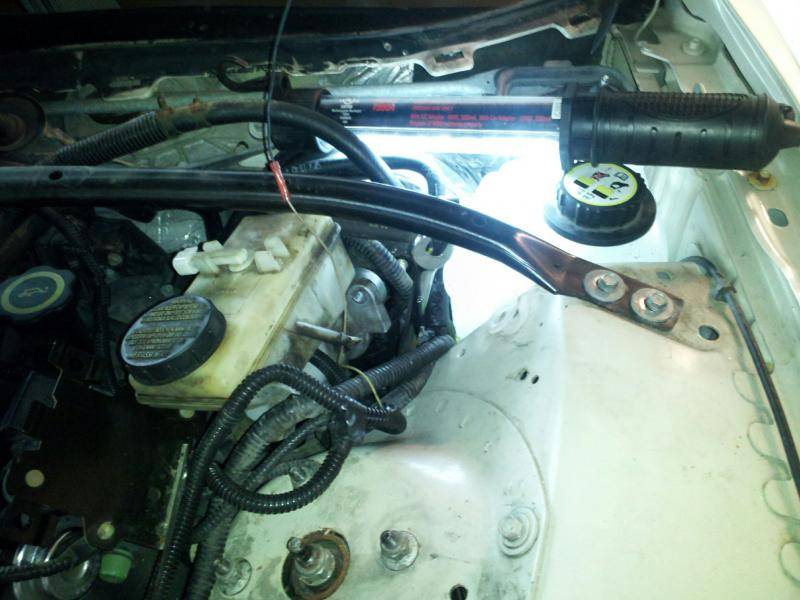

If you are replacing the front upper control arms you might want to replace your degass bottle if you haven't already. It will make replacing the driver's side way more easy. You will need to remove the shock to be able to get the bolt out from both side of the front.

Here I thought you didn't have to remove the master cylinder to do the driver's side uca. Would have made getting to that bolt much, much easier.

unbolting the strut tower brace and removing the two bolts holding the degas tank on yields enough room to get a gloved hand and wrench in the for the rear bolt.
I've completely removed the tank to do it, I've loosened the master cylinder to do it (per manual) and i've loosed the degas tank to do it, and honestly, while its a tight fit, just loosening and moving the tank takes the least amount of time.
just be sure to pickup the new shock nuts before you start the job. I've made that mistake once, only to find out the upper mount nuts had to be special ordered.

Is all this for the V8? On my V6 (with manual if that matters) I replaced the front upper control arm on the driver's side without touching the master cylinder or the degas bottle.

Mine is a V8 and the manual states to loosen the master cylinder and move it to the side. But its still tight. If I felt like draining and bleeding the cooling system, I would have removed the degas bottle. I don't know what the V6 looks like.
