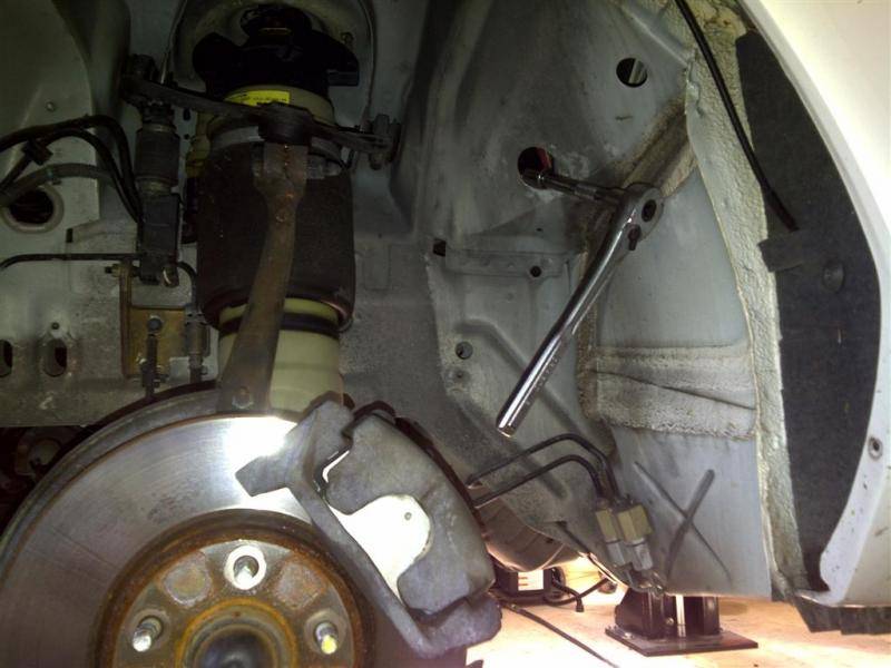

Try this way courtesy of Mad1stgen

Sapper, I am not sure but I think that access hole is already there in the car. As I said I am not sure, the picture is from Mad1stGen the Northern Guru of Marks. I do not think he woud drill a hole in a car to get to a nut just to make it easier.

The access hole on the drivers side is put in there for the cable on the cruise control, and provides access to the upper bolt. It already exists. Take a look next time you are working under the hood. There is no need to mess with the MC. This hole does not cut into the Tower at all.
