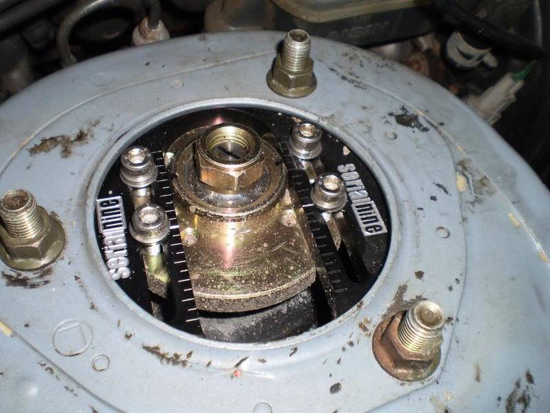

    I'm going to start a new thread soon, but the officially official word from Stance and TougeFactory is that this is happening (from the owner himself). I'm working on all of the specs and measurements this weekend. Prototype should start as soon as next week. Little tweaks from past info.
    A) It will probably not be an inverted mono tube.
    1) Our set up is double wishbone and would not require a dampening feature since this is taken care of by the wishbone set up (all single wishbone cars need this because the suspension itself is a structural component).
    2) This also means that you can adjust the suspension from the top of the coilover through the opening in the mount; instead of turning the wheel all the way to lock, reaching between the tires and fender and adjusting it blindly.
    B) There will be no camber adjustable plate on the top because camber is adjusted at the wishbones not the coilover itself.
    Both of these design adapations will lower the price, but will not affect coilover performance in the slightest. We're also working on having the coilover run all the way from stock height to 2 finger gap from tire to fender; with valving to run from close to sporty stock feel to stiff.
