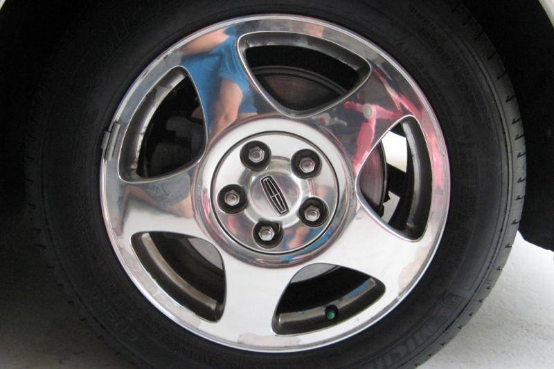

2 - The chrome is peeling off my rim. It's the not-attractive 16 inch. But I"m cheap and recently got new tires so I don't want to spring for a new set of wheels right now. Any recommendations?
- I'm being quoted $340 to re-chrome it, and $240 to strip and powder coat (x4 to get all the wheels to match) Am I the only one who thinks that's nuts?
- I can buy a refurbished one from Rock Auto for $193 plus shipping, or from Wheels America for $190 plus shipping. Anyone know about the quality of either?
- I can buy a take-off, supposedly grade A, from a couple of ebay sellers for about $100.

You can plastidip the wheels.
I debadged my gen2 and it was double sided foam tape. IF you still have the letter get some similar 3M and exacto it to match.
Around here it's $120-150 or so to straighten and refinish wheels and prob $75-100 more for chrome. About $100 each just to powedercoat.

Since the chrome is peeling, I think the wheel has to be stripped, first. I suppose if I went plastidip I could just buy a machined wheel and then dip them all. But what color? I have the tri-coat pearl, and these 16's would probably look silly in black.

I would keep an eye on craigslist. seems someone is always selling stock LS wheels... prob find a set of 17's with tires for less that 400
3m tape the emblem and buy a used wheel on ebay....like others said. If the finish is peeling off it may show up thru the Plasti-dip.

My grille and rear surround were peeling. I just sprayed the plastidip right over it without stripping it.

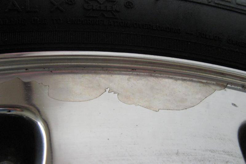

If they are the 16" wheels they are probably the polished aluminum, I currently have the same wheels. this is my second set. the first ones I had I painted black. the car is also black, I liked it for a while but got sick of it. The new wheels i got were peeling also but that is only the clear coat that was peeling. what I ended up doing is buying a few cans of the aircraft stripper and removing the clear then I polished them with Mothers wheel polish. I used the Mothers polishing cone ( works the best ) and used a dremel with the buffing tips to get into the tight spots. once the wheels where nice and shinny I sprayed them with a wheel cleaner and hosed them off, dried with a soft cotton cloth and sprayed 2 to 3 coats of the rustoleum wheel clear coat. They look perfect. If you would like me to post pics I have before and after. Total time to do everything was 4 days. some wheels were worse than others.
Pics would be fantastic. It sounds like you have handled the very same issue
Here are pics of my issue. Dlo has it right. I hadn't looked closely enough, just assumed it was a complete refinishing that was needed.
