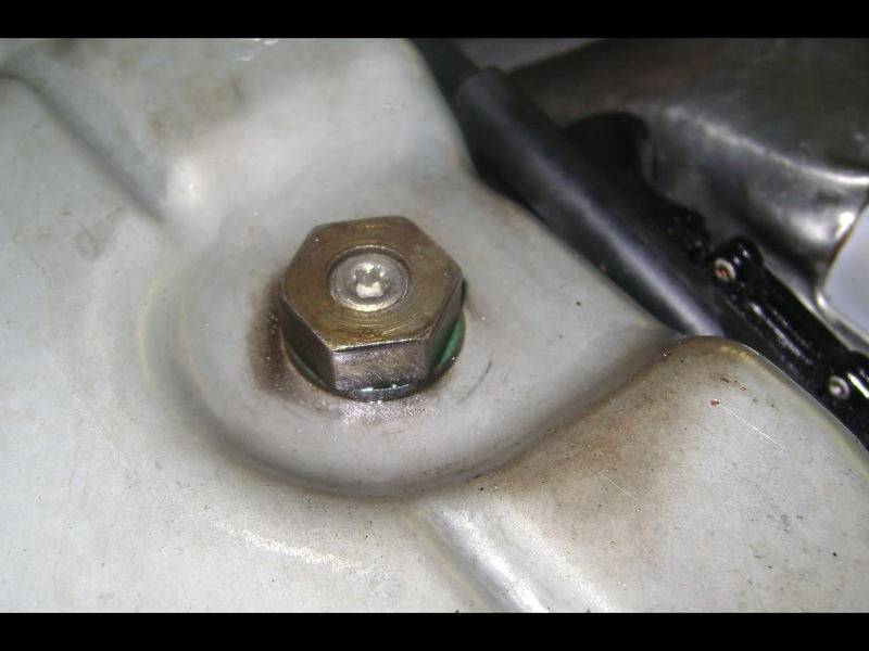

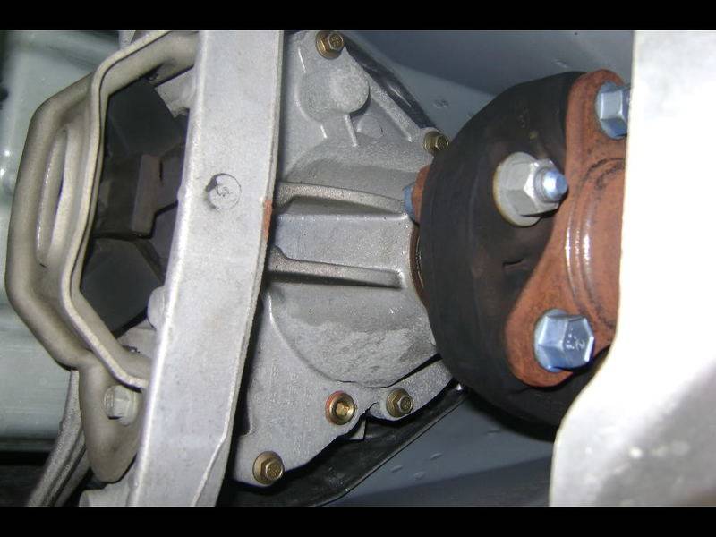

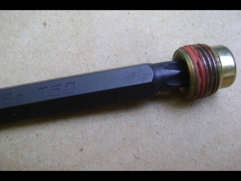

Ok guys I just bought my LS and replaced the motor and in doing so lost some trans fluid while pulling converter. I have the factory DVD for this and it states a whole 20 step procedure and needing special fill tool and vacuum tool. None of this is needed at all. Drive car get trans up to operating temp. I put mine on my lift so car is level and can get to everything. You will have to figure out to do the same. Make the car LEVEL. To check fluid level just unscrew the small center plug inside the larger drain nut with the car idling in park. If some trans fluid leaks out its full. If none dribbles out, put little plug back in bottom of pan. Unscrew the welch plug in rear of trans like right above the trans crossmember. This plug is facing the rear of car and is marked on the trans from ford. You need a way to pump 1 or 2 qrts of trans fluid in that hole. Start car and remove lower little plug untill fluid stops dripping out of the pan. When it stops drooling its full. Put all plugs back in and your DONE. Way to simple.

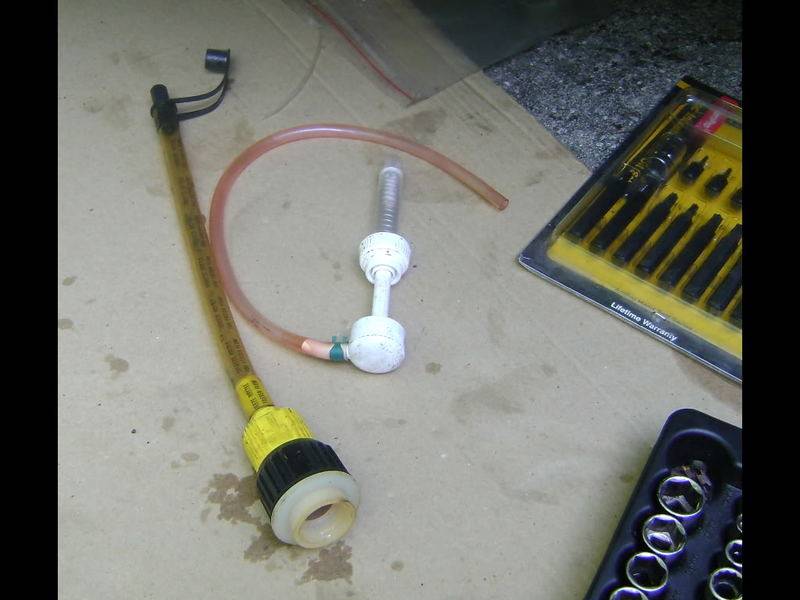

The main point being made is you don't need all the special tools ford says you need. All you need is the 14 dollar orange hand pump from autozone. Bet if you had couple of minutes you could use a turkey baster to shoot fluid in there if stuck for a pump. Just take couple minutes longer for a top up that is. Everyone in posts I read say its sealed its dealer only. I want to stop that talk with this thread when peeps search it.
well, i hope this thread helps me tomorrow! i went out tonight, pulled the drain plug, dropped the pan, replaced the filter, then started looking around for the dipstick - then i read the owners manual! yep i know! i was stairing at the wall trying to figure out what i was going to do. i had the idea of pulling the center plug from the mainn plug and pumping fluid up into it. I am hoping i will find this plug tomorrow morning!

You can pump it in thru the center of the drain plug. You will need a tube that has the correct pipe thread on end. Also if pump in thru bottom I just think it might be more of a mess. All over fill has to come down and down is on you. If filled from rear plug no nipple needed and that hole is up higher so no drool on you.

here are some pictures of what i did. i aslo ended up using about 5.5qts just changing the filter.
drain / fill plug
drain / fill plug parts
location of easy fill plug - see orange thread sealer
easy fill plug removed
pump i used to refill - i ended up using the white one - very easy
