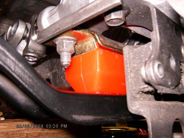

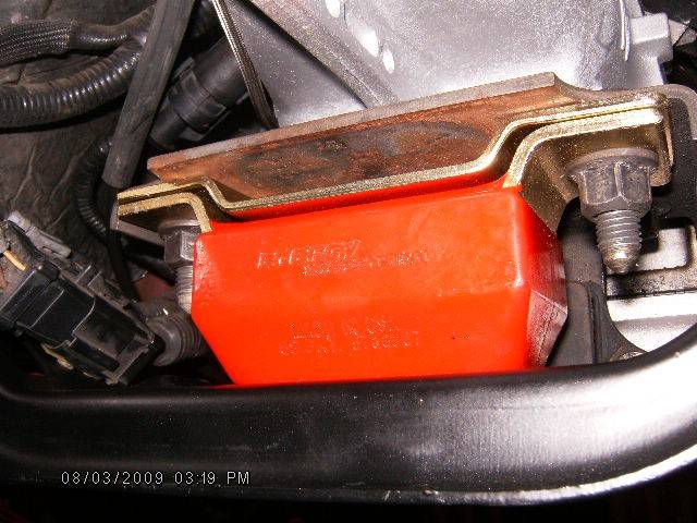

I used an Energy Suspension p/n 4-1104R mount. Also available in black or blue.
I removed the shot-filled damper from the cross-member and had to slot the mounting holes in the cross member a bit.

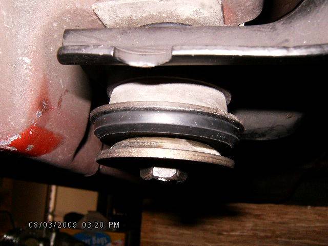

I also installed Poly cross-member bushings. The stock ones are an absolute PITA to remove. :eek:
BTW, I still have the stock mount (56K miles) if you just want that.

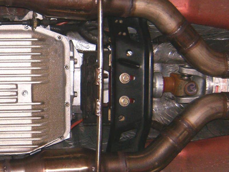

Just in case anyone else is thinking of doing this, I dug up a pic which will give you an idea of how much the slots in the cross-member will need to be enlarged towards the engine.
Just an FYI. In my car I did not have to slot them. I left it all loose in anticipation to slot them but as we bolted up everything it seems it was not needed.
Then again some people have to notch the pinch weld to clear the big front sway bar and I didnt need to. Have a good 1/4" clearance. :)
