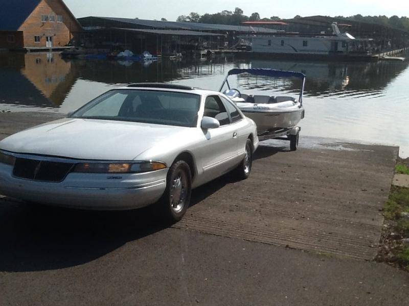

Wanting to make the pig into a towing beast. Currently has a class 2 hitch. Towed a 14 foot jet boat without a problem. She is modified as follows: 4.10 with locker, true duals, 2800 stall, stage 2 shift kit, electric water pump and a trans cooler. I am going to send her in for a refresh on the suspension. I am toying with having the motor pulled for a overhaul. If that happens I am adding headers. What else do I need to do to tow up to 4000lbs safely?
