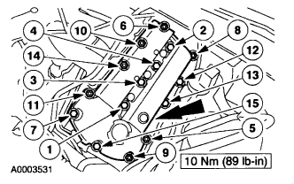

Hello every one... I've tried researching the site but so far have been unsuccessful. But does anyone know the torque specs for the valve cover? Im replacing the gaskets on my LS 6... Any help would greatly be appreciated.
They should be snugged 89lbs-in lbs. (about 7.5lb-ft).
Please note: INCH LBS.
You owe me.......
