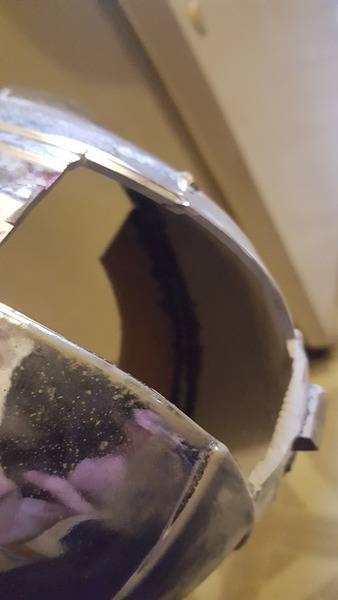

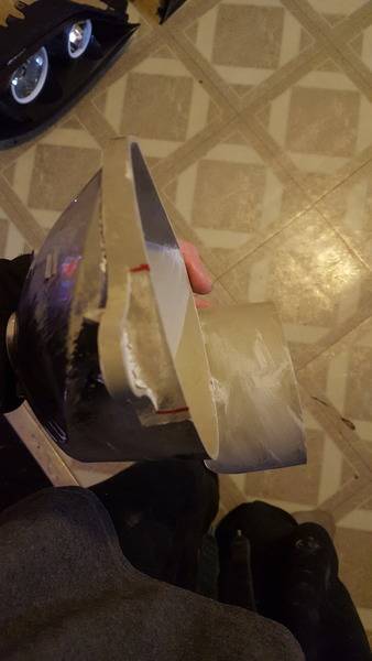

the reflector lens is behind that black plate with the l.e.d window. 2 strips of sealant hold the plate on. You can cut them off, and jb weld back on. no problem.
material used. plastic ceiling light panel. think 4x2ft sheet.

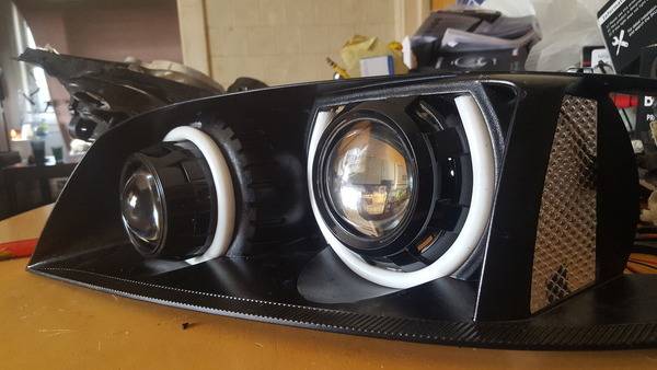

Next was the switchback halo install on both sets of headlight bezels (inside plastic trim)
Amazon.com: Mihaz Color White-Amber LED DRL Tube Light Car Switchback Soft FluxBeam with Signal-Sync for Headlights and Grills: Automotive
went with 2x pair of these per set.
Install easy... once u get tubes. u peel both ends off n pull led strip right out of the silicone tube. that way your able to mold a nice tight oem effect.
Then once tubes are all shapped up and look proper you can cut led strip and slowly feed it back in tubes. strips are cutable every 3 leds.
Picture has said clear corner and cover
also something i wanted to point out is with these specific led tubes, the top (opposite frm mounting hardware supplied) has most output.
And if you look real closely at the low beam circle you can see i mounted brackets to face out. instead of inside., firing toward one another. but later on my second set. I ditched mounting hardware and just siliconed everything in. less tedious.

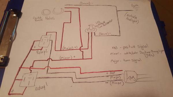

ive came up with a nice detailed diagram of how to wire 2 relays (5pin but only use 4)
1 thing that I MUST!!!!! LET YOU KNOW!!!!
using the cheap brand of switchback bulb that i got. with the halo rings/tubes will not work together. lol
havent pinpointed it. turn signals all fuction in sequence and halos take over as daytime running light DRL
Even when i had halos running on seperated 12v. nothing. same result. even wired up relays with different 12v source n same. so theres gotta be feedback somewhere. its probably super simple.
switchback bulb by itself. wrks flawless... halos n tubes wrk flawless. them together? lol not so much but im totally digging the outcome. its only a tiny flaw in my eyes.

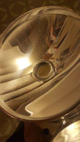

now this is the led that goes behind clear corner. i figured. hey. its got to be white. reflector was super amber. but no. you can either not use it at all... or you can do like i am n solder in white micro leds.

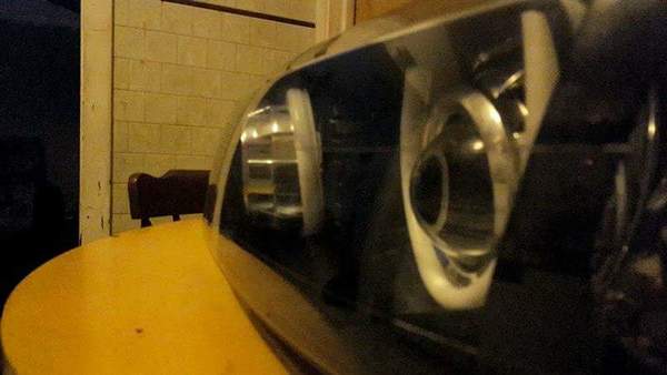

now on to the low beam. FDR n I have been noticing how kinda the low beam actually sits lower. u can see now bttr with projectors in
received_10154087206392371_zpssnlvxxhx.jpe
I also threw on the lens to test fit that high beam projector. kind of stuck out but i got clearance with no touching. hopefully ill be alright. i dont use high beams much anyway.
received_10154087269557371_zpsymvyizfx.jpe
Big bummer on low beam.really wasnt gona stop me now. I guess nxt step would 1. get it to an ideal looking location inside bezel and 2. try n be level with high beam

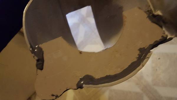

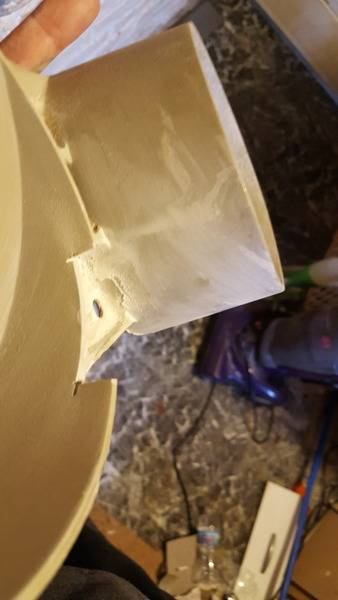

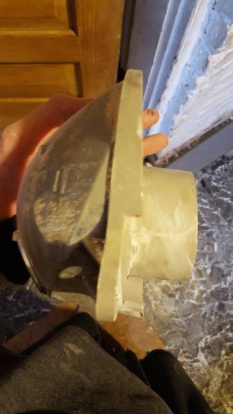

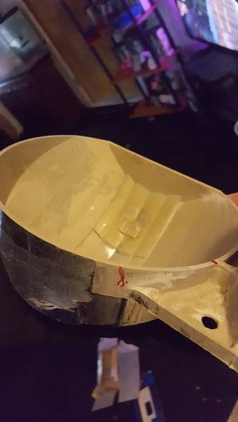

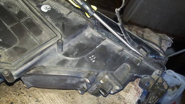

After jus looking at the bowl i knew making a plate to mimic stock adjusters would be best to fit n lift projector up. but still be even
This is wat i came up with. made a plate that fit inside of bowl. i had also cut bowl at bottom to line up straight because of the angle bowl is originally at would have projector aimed high.
i also cut backside of bowl to give me room to wrk and figure rear mount location.
And i j.b welded the Bleeep out of the plate.
Lmfao of course inside as well.
And after
Id have to say im much more happier...

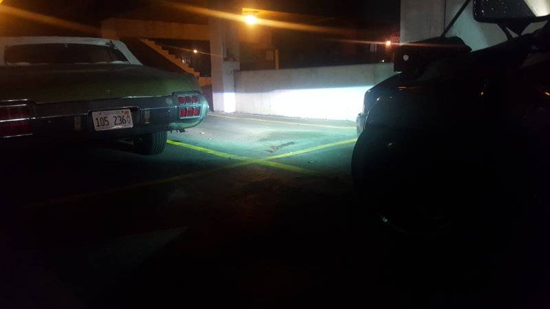

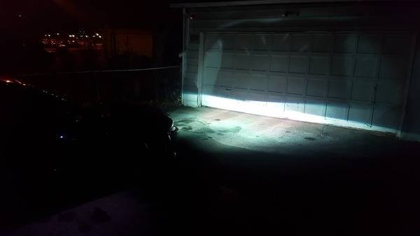

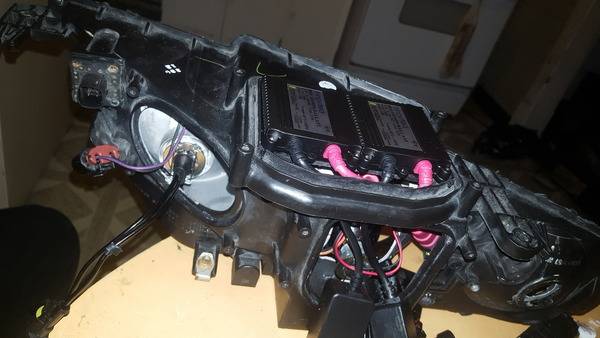

so i get a cheap hid h1 kit to wire everything up n check cutoffs before i seal everything all up.
So far everything has been by eye and done in the house... found an extra set of h.i.d ballast covers n they work well for me.

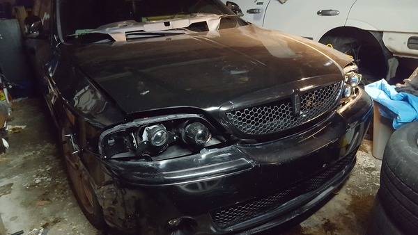

now to check it all out.
I know, I know. dont laugh. it was all an eye ball. but so far thats where i stand. high beam n low beam are dead on. just need to rotate my low beams so cutoff is nice an crispy.

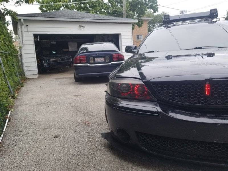

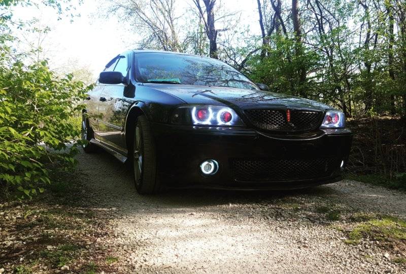

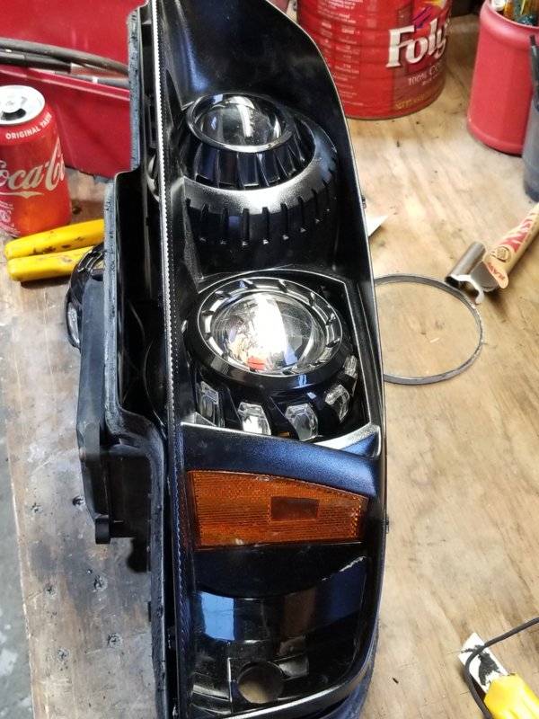

Anyway, after finally getting my rotation right. I tossed together the build n was ready to rock em n see how'd they do.
As far as how well the output was driving, id have to say. Hands down a HUGE upgrade from even my stock H.i.d units.
I added a bit of flair with a then popular starry night led kit as an active demon eye effect. Worked great for some awsome pictures
The defused led strip i eventually had a wiring issue with and just turned off the white.
I also kinda noticed after that the bright white would take away from the color modes.

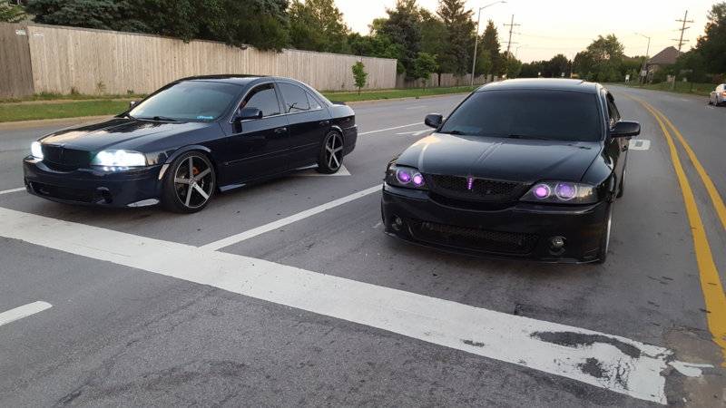

With all those issues arising of course me being the perfectionist i am. I started on build number 2. N tore down the original set to save on cost n time.
Now for my 2.0 set. I wanted to fix the halo effect. N probably ditch the whole concept all together noticing how it was just too much for me personally. N i liked the demon effects more.
(Although im still a fan of switchback functions )
Ditching the tubed halo also gave me the chance to finally get a complete blacked out look inside.

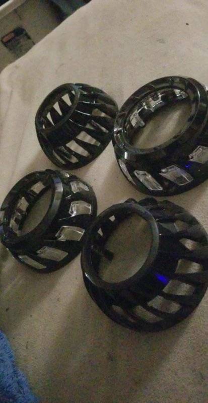

And of course, i was able to play with different styles of shrouds
Turbines being my choice of weapon this time
So as the years passed, starry night halos as a led supplier was a fail. As they closed n had bad services.
I reached out to Lighting Trends. From what ive reseached, n after so much debate about starry, they seemed more customer backed. As i have already had shipping issues n they helped quick n easy.
The kit i decided to go with was a RGB-A style flow series. Which means i pretty much have the same setup as starry nights did. But i also have a built in white drl mode, as well as a sequential switchback mode that corresponds with my turn signals
