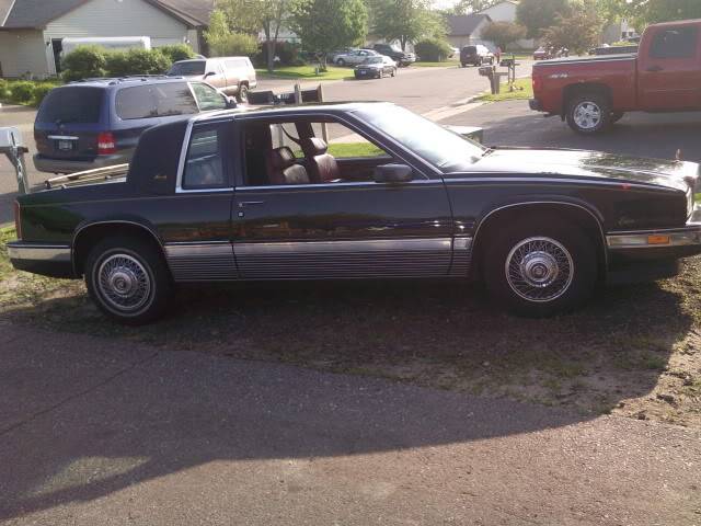

I'll post a pic of mine. I'm pretty sure it's OK. I drove it to the car show in Minneapolis and the temp was fine.
Mine is an '88 which came with a throttle body injected 4.5. That engine was replaced with a low mileage 4.9 from '93. The 4.9 had port fuel injection, plus that intake was fire damaged so Tim and I swapped intakes and used the intake from the 4.5. So now I have the only TBI 4.9 I have ever seen. It has Chevy 5.0 injectors and I made the FPR adjustable. There's no such thing as TBI 4.9 injectors.
My Eldo. I've never seen another one quite like it. I've since turned the whitewalls in on the back tires.
