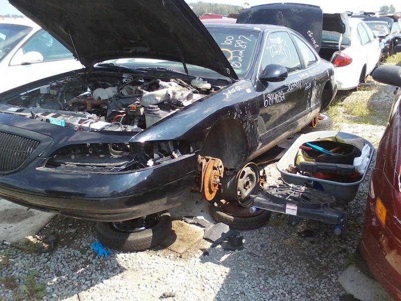

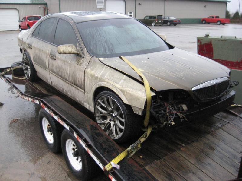

Purchased one 1st gen Lincoln LS for like $600 in the middle of Wisconsin, in the rain. This was after the car salesman of a large Wisconsin dealership hit a pothole and dumped all of the oil. Upon realizing he was highly intoxicated, he proceeded to try and drive the car back to the dealership, or his house. The engine didn’t last long and imploded.
This was around… 2011… I got the car and then a lot happened with life. Insane job, no garage, etc etc etc. All the excuses in the world but I did the best with what I had. I’d drive 2.5 hours home and work a little here and there in the dirt floor open shed an usually destroy more then I fixed. At some point the power outlet stopped working so everything became very limited. Not much happened during this period car wise, but I started accumulating parts.

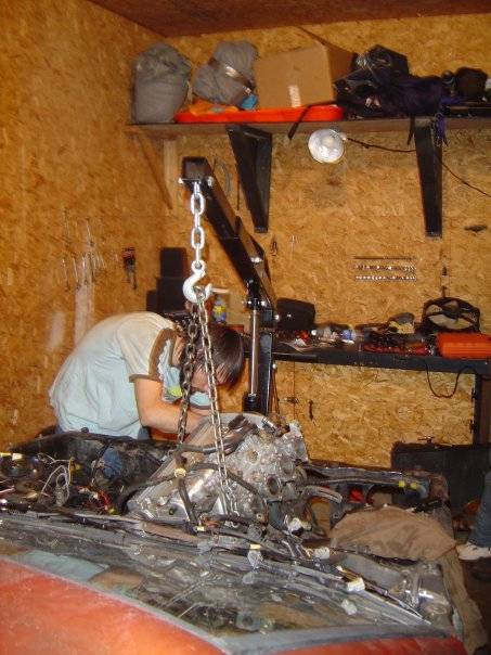

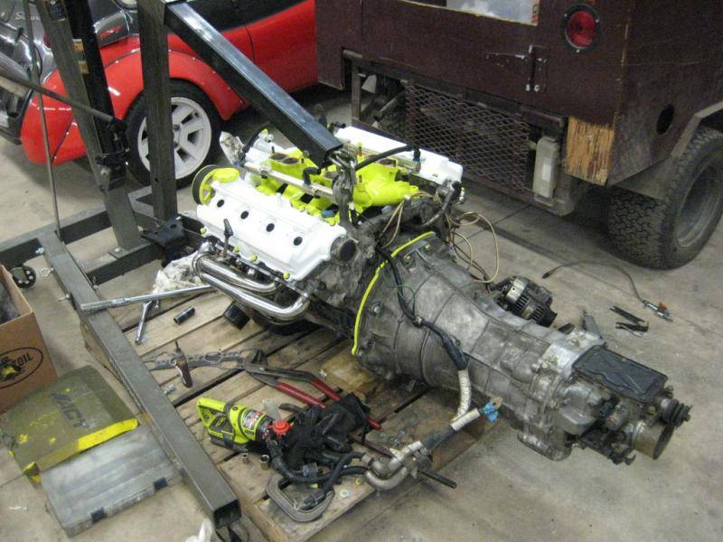

Test fit was like a glove! This is bolted in also.

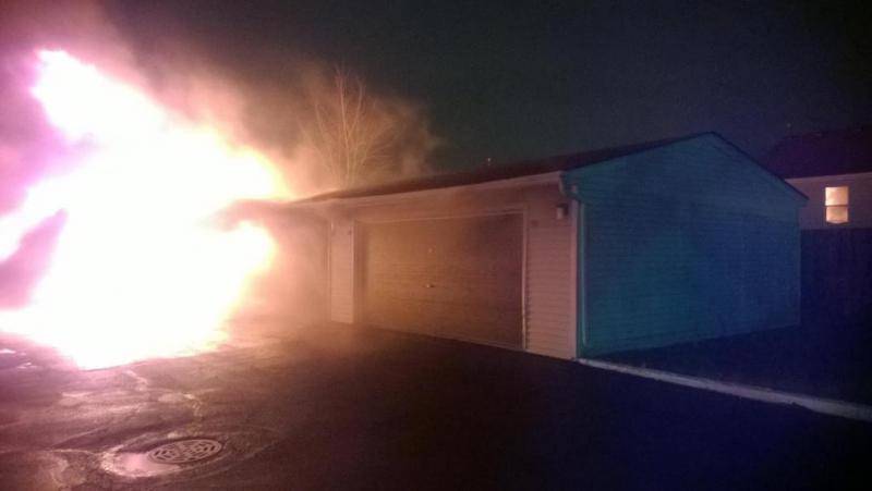

Until…

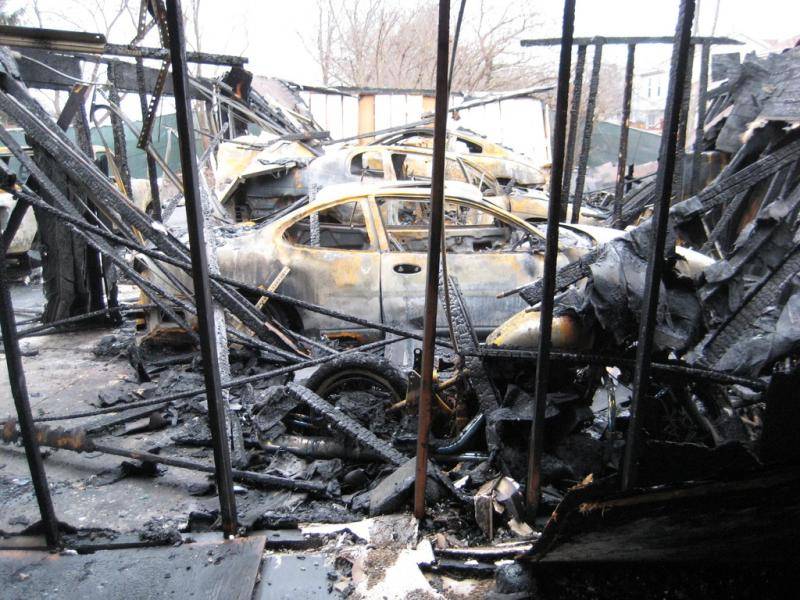

My spot at my apartment is 4 garage doors with 8 spaces for cars. My space is on the far right and I share that with Vito who owns a civic and a Harley. Places next to me are a chopper, a Grand Prix, then the epicenter of the fire, and far left is a Taxi driver and some random car. The epicenter of the fire is a spot where some mechanics work on local cars under the radar. They help out but in this case the Monte Carlo parked next to a G35 blocked in by a Ford Ranger was their demise. Deciding to break a fuel line hose that was stuck with a blow torch was probably also a major contributing factor.
Insurance is still being settled from this case because not only was there a fire that was covered with the bare minimum liability insurance possible (everyone in our apt complex has to have renters insurance) but then a couple days later this happened.

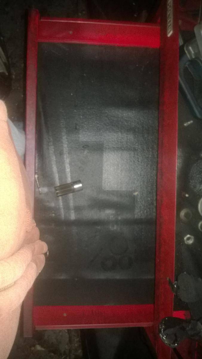

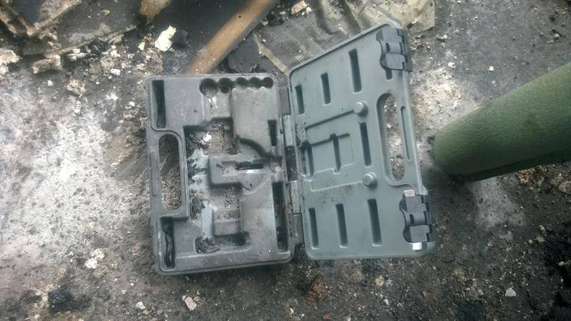

That’s right, people decided that they deserve my stuff more than I do and walked off with a vast majority of my essential tools… (welder, tool bag of about 100+ tools, cordless impact, cordless drill, etc.)
Summing up my feelings.

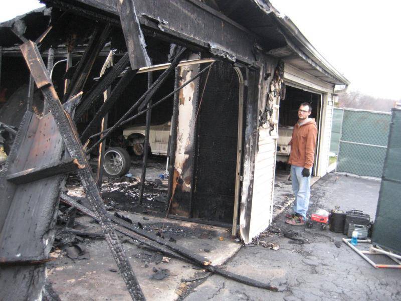

After a lot of work and a lot of cleaning (the smell of ash/firehose sludge and burning plastic will never leave everything) and sorting ruined vs salvageable items, I’ve moved my stuff to Crab’s golf course.

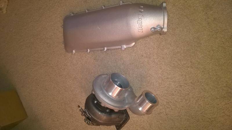

Oh and new turbo, since well the first got stolen and the second was destroyed in the fire. BW S300SX363 .91AR

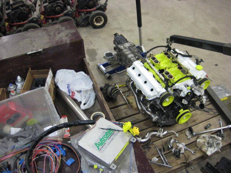

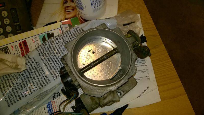

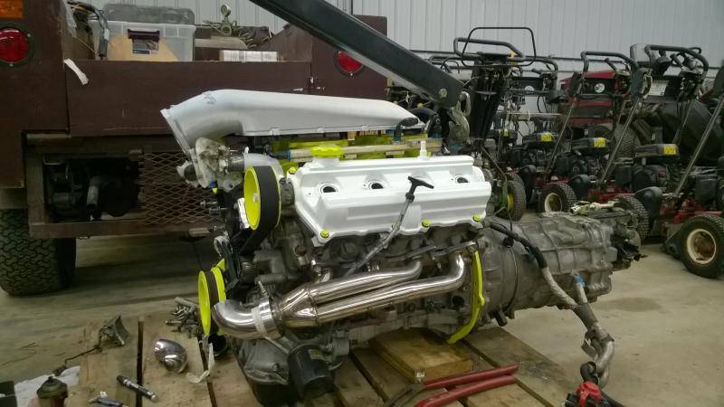

3UZ Tundra headers flipped over for turbo. I’m also using a LS1,2,7,X,10293812038 for my intake. This will take some work and a throttle body from a rolled over GMC Vortec at the junk yard (my affinity for junk yards is insane, I love them).
This motor requires a lot of small things that would bore you since you don’t have a 1UZ in your engine bay. Figuring out how many crank teeth to cut off, in what order, and run for wasted spark on a stand alone V8; which coil-on-plug is best (turbo Porsche vs LQ4); systems that we can retain in the INSANELY intricate LS wiring system, etc. There are 1000’s of little things that have to be worked out. Thanks to this forum, friends, and the internet this project keeps getting closer to completion. It may smell a little like smoke forever, but who cares. This thing should be fun when finished.

So basically all engine functions will be controlled by the Autronic SM2 stand alone ECU. The windows, locks, and other various functions will still be controlled by the LS system. Oddly enough parts like the gauge cluster functionality was difficult to determine the level of connectivity with essential LS systems. So to counter-act this we are running a MGL gauge off of an airplane, boost/tach/AFR individually and then the other gauges/indicators/warnings from the LS. Fuel related systems were interesting and left to Mike and Crab. Climate control is being controlled through various parts hooked up to a F-8 Crusader Fighter jet panel. I'd post the gauge cluster but it is being non-suckified at Autometer right now. I have a knowledge of tools and mechanics; electronics still baffle my mind. Anything electrical is left to Crab and Mike with me looking on like I know what they are doing. I have made it a goal for 2016 to learn basic electrical. No updates for about 2 weeks as everyone is on vacation. I will work ahead in my FAA certification tests, so I can thrash when everyone gets back.

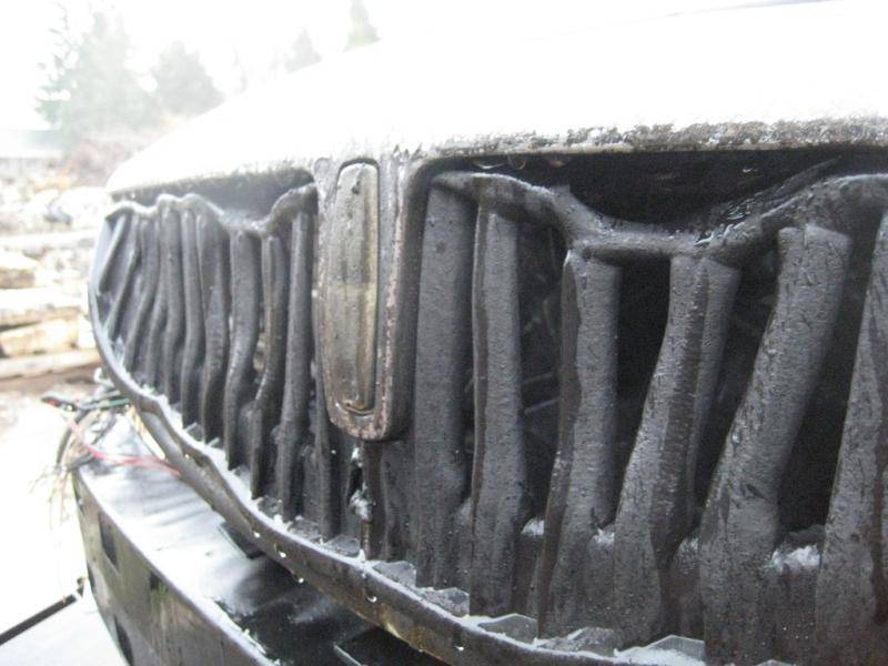

And don't scrap that grille. It's already thermoformed and the 'grin' would look sick on the finished product lol

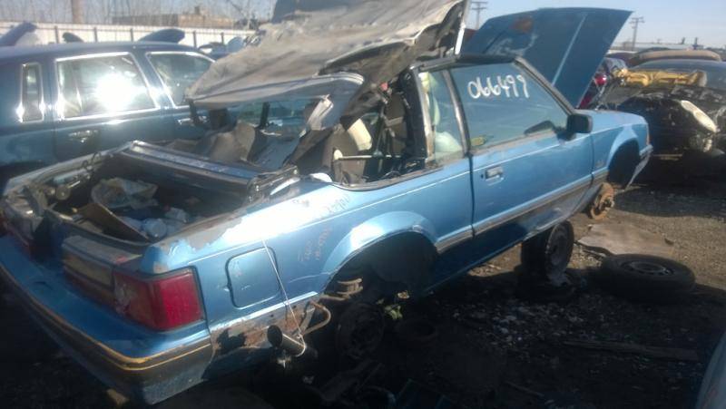

First, Aaron grabs the 28 spline Torc-Lok LSD from this beautiful Mustang.

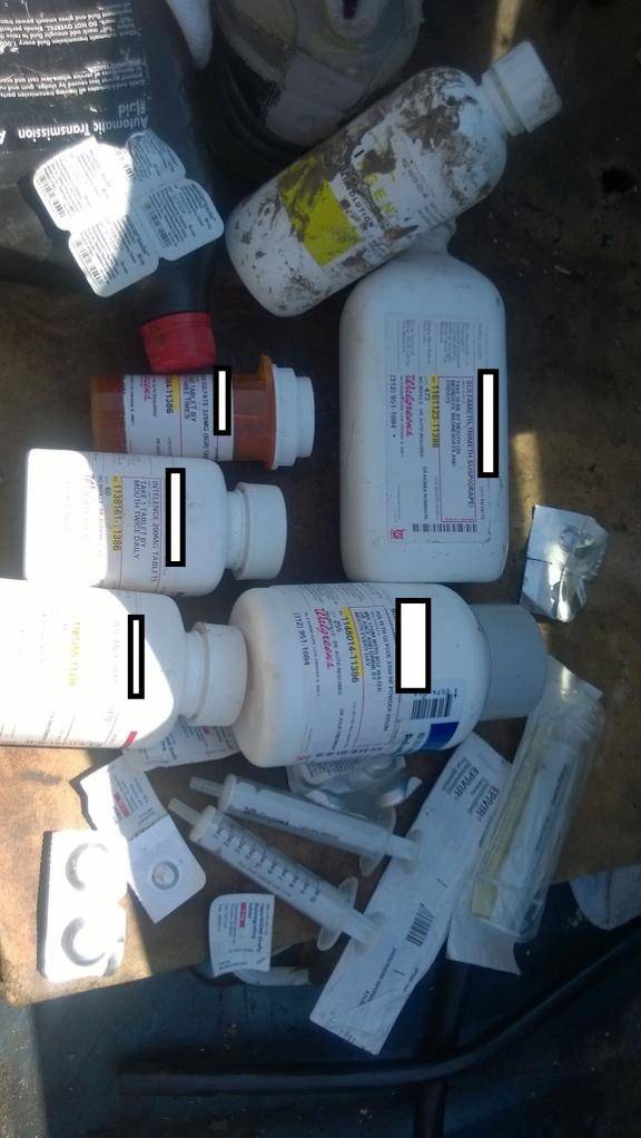

The trunk is full of prescription meds, naturally.
He works under the 'Stang until thoroughly demoralized. The thing was stuck in there for some reason, so he thrashed under it for hours. It finally came out after he used the axle shaft to pry on it.

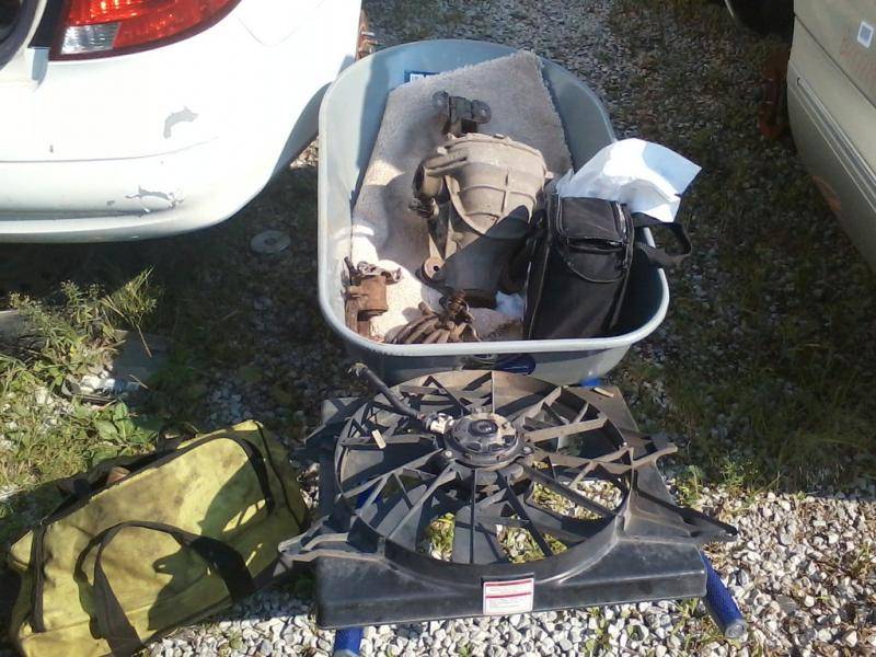

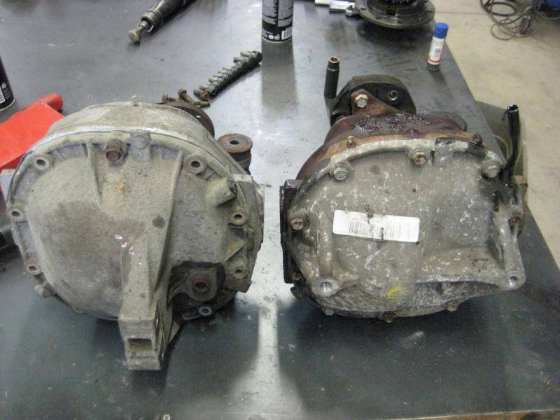

Next, I grab the 8.8 IRS carrier from this Mark VIII. This is the same unit used in the Terminator. God damn, this sucked bad. I had the carrier loose fast, but the car's dual exhaust was pinned on the stands, trapping it in. Now that I think about it, I probably could have found a way to jack the car up, but my brain got melted in the 100° temps. I finally wrestled it out, throwing the 31-spline axles to the side that we will probably need later when it shreds the 28's.
I'm always mindful of these cars because I actually think they're cool, and they come with this badass fan. The fans are usually gone, but this one was pulled by someone, and left. I found out later that the low speed circuit was dead. I'll just figure out how to drive it on low with a resistor or something. Fitment is perfect for the LS radiator, and the flow is legendary. This was a half-price day, and I got all this for like $50.

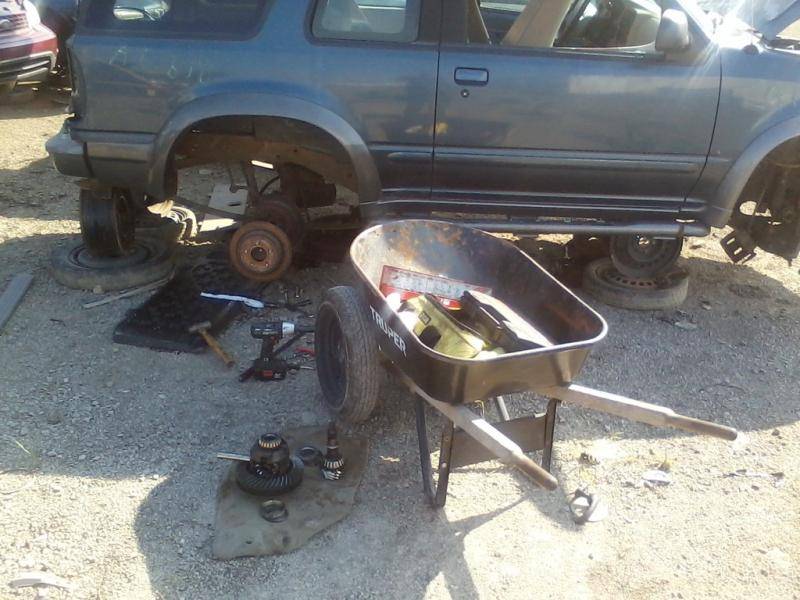

To complete the scrounging, I found a two-door 4wd Explorer with the rare D2 code rear end. I didn't know they made such a beast. This has the 4.10 R&P with another Torc-Lok, a 31-spline. After breaking a wrench in half right away on Day1, I had it out the next day in 30min. I gave the counter lady a plausible sounding name for this greasy part inside my airbag carrying satchel, and got it for $30. These LSD's sell for like $150 all day, making this entire mod please my financial sensibilities.
Then Aaron pulled diff #4 out of his Lincoln. Don't need this anymore.

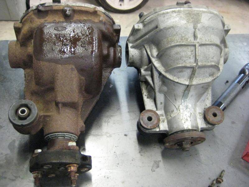

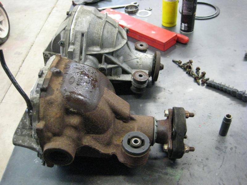

Right. Now we disassemble all these diffs, and play mix'n'match. To recap:
-Use only the MarkVIII housing so the 8.8 gearset can physically fit.
-Use the Stang 28-spline Torc-Lok LSD so it will fit the LS axles.
-Use the 4.10 Explorer R&P cause it doesn't suck.
-Sell LS diff for profit, because it's just one of many things on the car that commonly go bad, and is therefore in high demand.

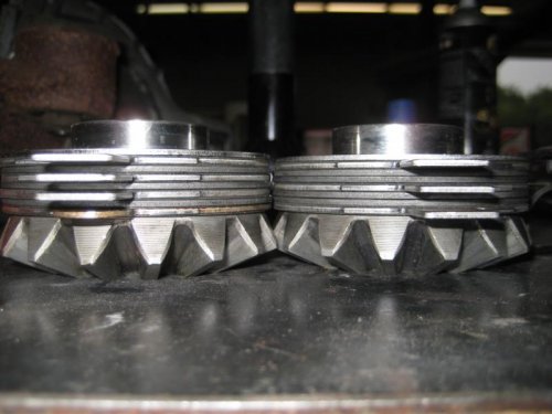

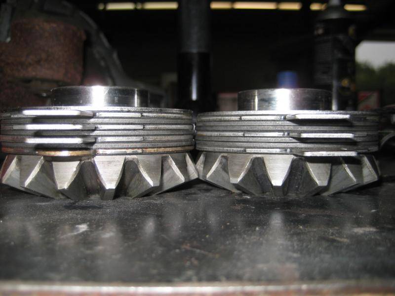

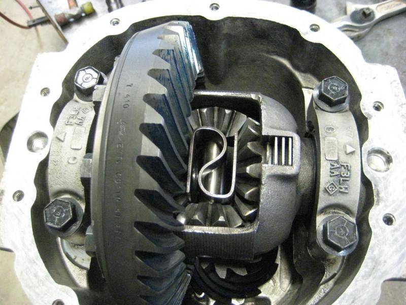

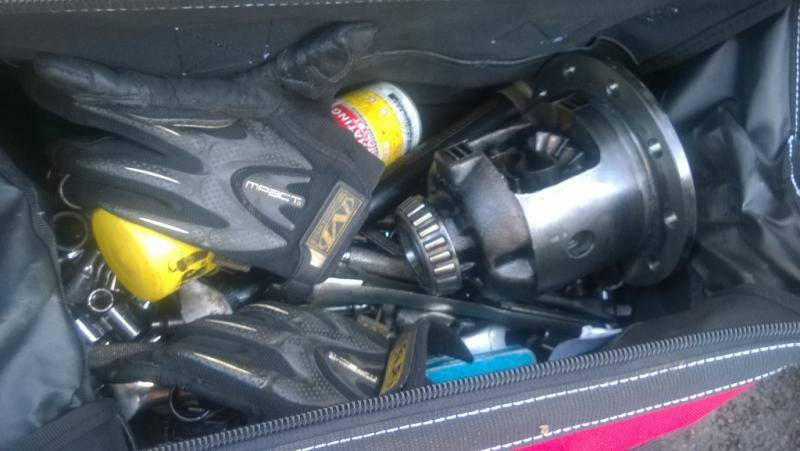

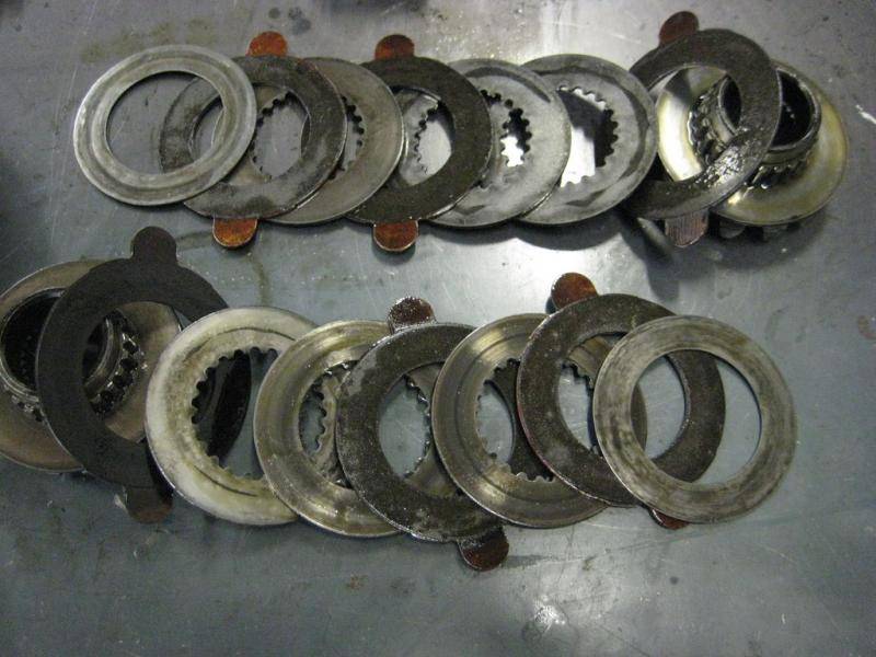

I worked some magic on the diff. The frictions on both examples were still in great shape. I just re-dressed the plates with a scotch-bright disc.
These are actually nice looking units. They use the spider gears as the "ramp" to apply pressure to the clutch pack, achieving lock (Lok, sp?). Still, I found Ford's methods puzzling concerning the stack.
On the right, as pulled.
On the left, Crab style, with an additional friction plate stolen from the Explorer LSD.
This takes it from 2 1/2 friction plates (the top plate goes against the case and does nothing) to 3 1/2 per side. It also shims the stack .120" total to increase initial torque. Everything was so tight, I could barely reassemble it.
The fun's not over yet. The LS rear cover needs to be swapped over. Also, the front mounts are lower and there's two of them now. This will require some new brackets on the subframe.
There's something awfully familiar about all this...
Not covered or pictured is the custom dif mount that is being run for the new mounting location. The rear fits because the LS plate is retained and the front now has two mounts. The one stock LS subframe mount is soooooo close but just short, so Crab crabricated some new weld-on brackets. 4 mounting points will now distribute the power from the custom drive shaft (yet to be made until engine and trans is mated). Engine and trans mounting has some fun things, but we are a little ways away from that since the awesome paint job I did in the engine bay is ruined from the fire. I have about 1 week worth of work to get back to zero with the engine bay...
