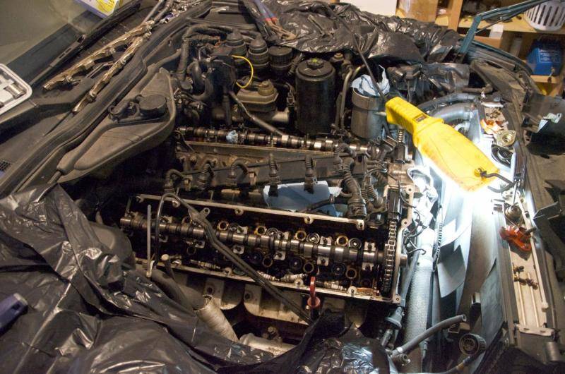

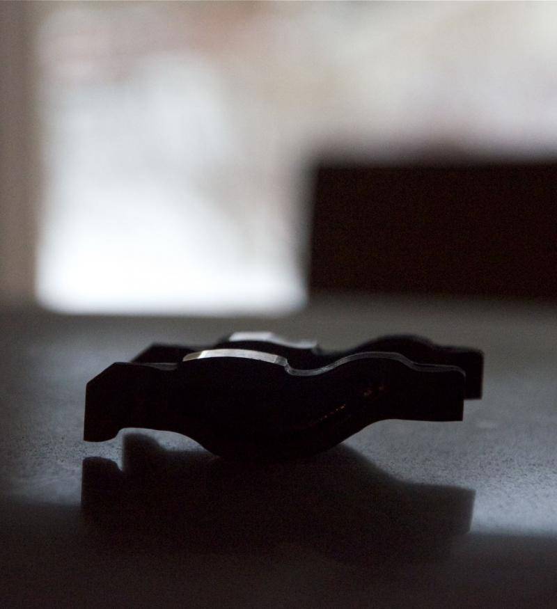

But now I have my tech "fix". A car given to me for my b-day that needs some work. It all started with a loud "tick/squeak/tick/tick/squeak" from the valve train. Being familiar with the notorious 95 Mark model year, I suspected a broke valve spring. Nope. Not by a long shot. The cam was not being oiled well enough. The oiler bar had lifted up as banjo bolts came free. One lobe is in rough shape. The other side was far worse though. So far I need two cams and several rockers. And about a billion gaskets when it all goes back together.
1992 BMW 750il with 5.0l V12 - rated for only 250hp, limited electronically (well, it was).
