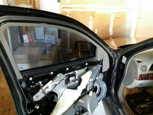

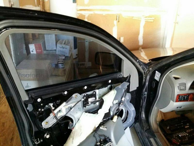

As we were about to start loading the truck to move to a new house this weekend, guess what decided to go in the driver door?
Well, luckily I've read enough on this forum to know this was coming. I was in a bit of a hurry, so I ended up paying $185.93 + tax at the local Ford dealership for a new Window Regulator. Because I've seen so much on here, I knew what I was looking for before I cracked the door. One piece shattered and the other was falling apart. Now the window works like new... Wish I had metal clips to replace the plastic crap.
The procedure was pretty easy and straight forward. A power drill with Torx bits and socket bit makes the job much easier.
I had to use a method that involved removing the fuse to rest and reinitialize the window.
Approximately 2 hours of work and $200 after taxes.
