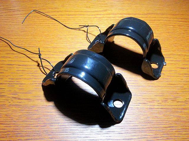

Sand blasted, primed and painted the old stock front sway bar bushing brackets.
Ordering the Jaguar Sway Bar Mount - Rein XR819697 30mm bushings
from FCPeuro and swapping out the Energy Suspension bushings at a later time.
