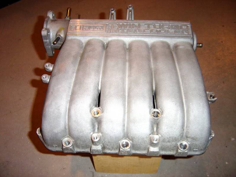

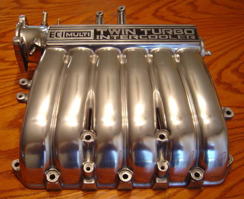

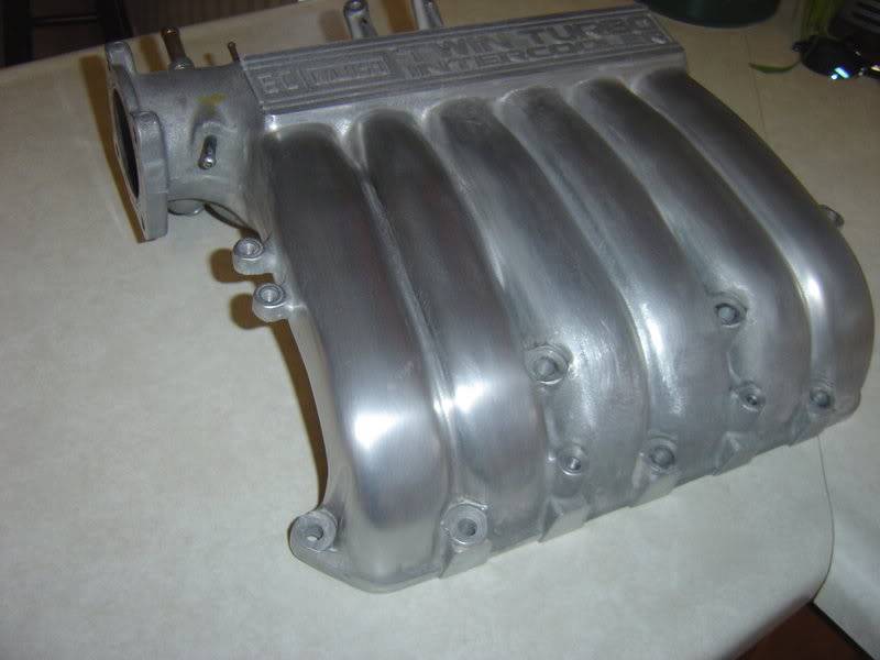

As far as the polished intake. I store my VR4 over the winter so I just took it off in Feb and worked on it until I was ready to take the car out for the summer. It really wasn't that hard to do, it just took a lot of time. I bought a hand sander from Walmart that has a point on it (looked like and iron). That got to the hard to reach areas. Just start with rough sandpaper to get rid of the rough finish. Then slowly use finer and finer sand paper. Eventually I was using 600 and higher. Then hit it with a polishing wheel and presto it shines. It looks good but I know I could get it better if I took a little more time. I just wanted it back on the road so I quit before it looked like glass. I didn't do the bottom because no one will ever see it. Right now the car is still in storage and this is the first year I'm not going crazy to get it out. I like driving the Lincoln so no hurry for the VR4.
Here are some pics of before during and after.
before
During
After

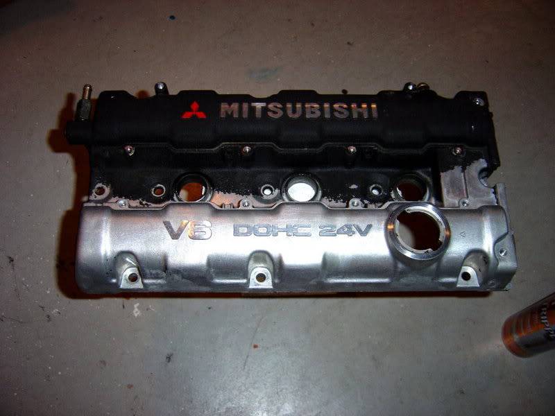

Starting on the valve cover. Just applied paint stripper to half of it. Worked awesome. Hardest part was sanding around the letters!
