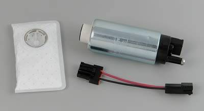

the picture looks just like the 255 kit I got from 50resto.com.
I went back and looked at their site and now they are listing that same edlebrock kit, complete with the same picture.
I'd be willing to bet that when you get that Edelbrock pump if you look on the bottom side it will say Walboro.
I click on this link and it says that the kit was just for chevy's but like you said this kit will bolt right up to a gen 1 mark with no moding needed right?

this is the picture of the pump that edelbrock has on there website for 3581 above.
this is the same part number listed on summit racing 3581. different picture?
well its listed under the same part number, im thinking ones just a general fuel pump picture.
