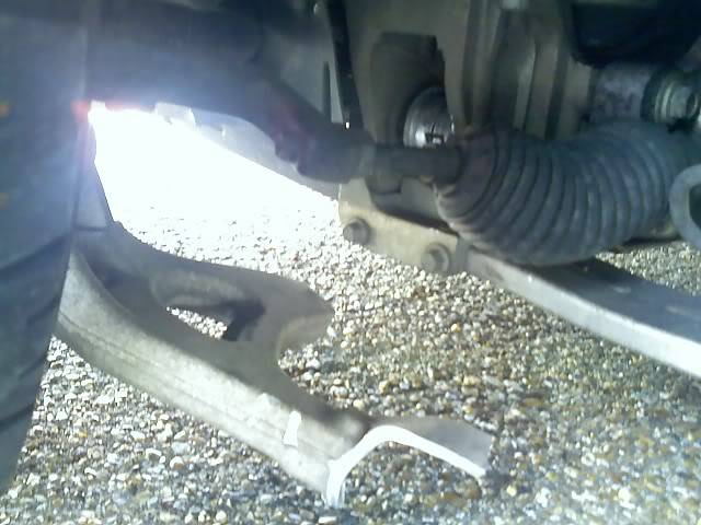

A great day turned into a horrible nite.... Yesterday. Well everything seemed to be going great yesterday after washing & cleaning my baby(2004 Lincoln LS) up. So i decide to go clubbing everything went great until the club let out. People & cars where everywhere which is normal for a Memphis club scene but this wasnt a regular night. Somebody called themselves swerving on me & i called myself avoiding them but HIT A CURVE!!!!! Now my car is totally out of commission. The car wont crank, this driver side fender wall came out, the driver side front end is sittin on the tire, & i suspect that the control arm is broken. But honestly I have no idea so i was wondering could anybody help me out just by reading what happened. With a list of parts, prices & a labor cost would be a great deal of help. SO PLEASE COULD SOMEONE ANYONE HELP LIL OL' ME.:confused:

U guys have already been a big help. I checked out the fuel filter & its fine. The car doesnt leak any fluids so that part is fine. No what i do not know is whats bent. What should i be looking for??? Im headed back to the body shop now so i can snap some photos for u guys & hopefully that will help u guys out on feeding me the exact information needed. Thanks alot. Ill be back soon with pics.
It would be hard to guess with what you've posted. Pictures will tell the story. You are going to be dealing with upper and lower arms, the struts and mounts, possible frame damage, steering all the way from the ends back through the rack. Any and/or all of these items and more are in play.

Well guys Im just leaving the repair shop........... And things turned out to be alot worst than earlier expected, ALOT WORST. Turns out rainjacks is completely right about this situation. An that totally sucks!!! I walk into the body shop and talk to the receptionist and she knew who I was after describing the car but at the same time she didnt have a clue to where the my car was. So after a few phones call the car was there. So me and one of there experience tech went to take a look at it. (Turns out I couldnt see jack in the dark last night. Because I totally missed informed everyone. Might have been the Grey Goose.) So he gets under the car and describes the situation as fairly damaged. Sike.... Thats truly an understatement. The lower control arm was snapped like a twig, the shock was bent, the wheels are totally out of aligement, some minor body damage, the fuel filter is bent after a good look at it & on top of that I have broken heart. So we started to talk rates and he said its 2 to 4 grand to fix the problems that he has observed but he also said after fixing those problems, some others may occur thats not visible at the present time. So after fixing the original problems other may occur!!! This sucks more than having to get the motor replace from a flood damage recently. Not to mention that was $4800. Well does anyone have any ideas??? Pictures will be posted soon.
Yah find a close friend that works on cars. Go to boneyard get lower control arm and strut for like 150 bucks and have him put it on. Then get an alinment. Worry about slight body work later.

The lower control arm was snapped like a twig, ... the wheels are totally out of aligement...
Don't worry about the wheel alignment--it's irrelevant right now. If the LCA is broken, there's no way to align the wheels. It's like saying your driver's door won't stay closed when the B-pillar is gone...

Well it took alot loner than expected. Had to find a better browser to upload these pics but there it is & man I get mad everytime I see it. The total repair shop cost is $3485 to repair all visible damages. An after all repairs are finalized there's an second inspection to make sure there is nothing else wrong with the chassis. So until then Ill keep everyone posted and thanks everyone for being so helpful.
