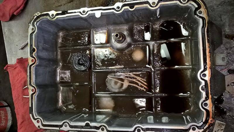

Hopefully when the pan comes off it won't look like our 2003 did. (below) We put in a ETE Reman re-manufactured transmission last November, supposed to be better than new. 3 year unlimited miles warranty. So far so good. Works well. I just contacted them via chat and asked if they ship to Canada, they don't, but anyone in Canada can order via rockauto.com he said. Hopefully you don't need this RigsLS, just thought I'd put it up in case someone reading this in the future does.
Their website has a lot of information: ETE Reman | Remanufactured, Rebuilt & Used Auto Transmissions & Repair
