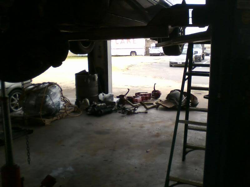

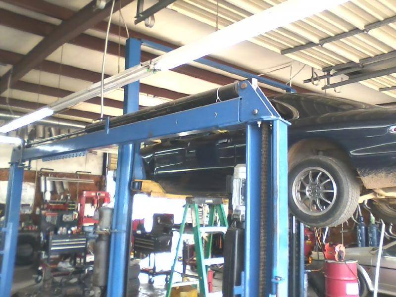

Loaded my subframe from my old 95 into the trunk of the 97 (the one i built with all polyurethane, new rack&pinion, new control arms, and new hubs, new calipers, and crossdrilled rotors.)
Drove to my local shop where i am allowed to work on my own vehicle with shop assistance.

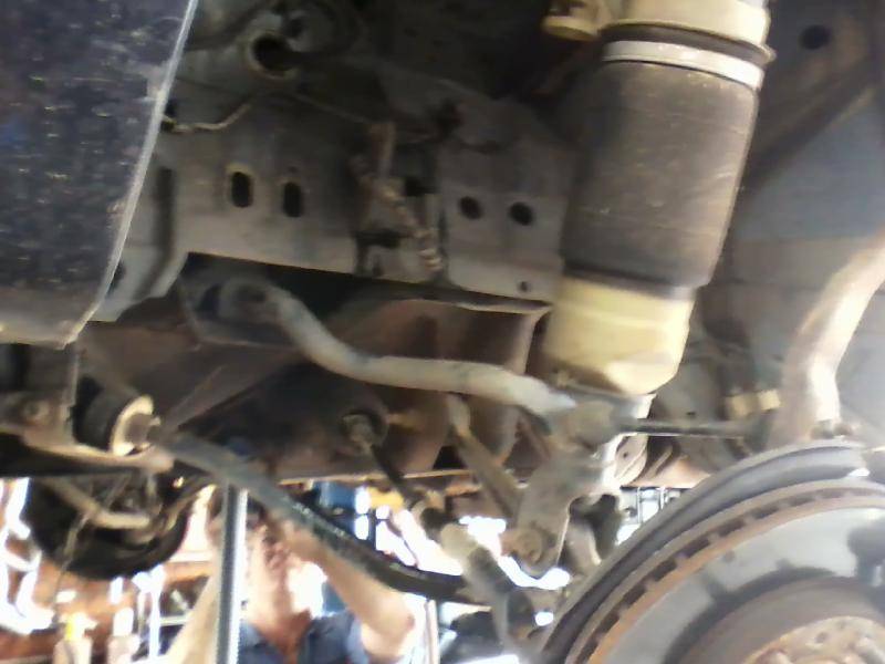

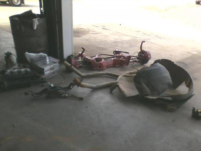

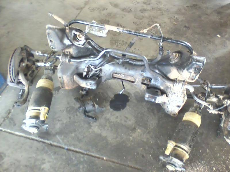

Proceeded to brace engine from above, and remove entire cracked and sloppy front suspension at once.

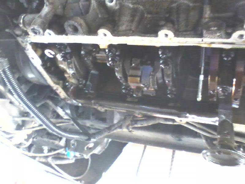

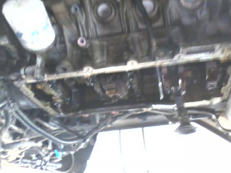

when it was down i noticed the oil pan was leaking, so i got a new gasket and did an oil change.
MIDDLE OF ACTION ON THE LIFT

I then removed the manifolds and mid pipe, and replaced them with 2004 cobra manifolds and a offroad xpipe, blocking the egr pipe off along the way, and here is where my problems began (details at end).

well i just finished up (as i was typing the thread), draining all the oil i put in yesterday, and replacing the filter, i just cut open the filter, and i dont see any shavings, and the oil i drained looks immaculate,
i refilled her with Some high zinc stuff i had for my 460 builds, and a new filter.
so Fingers crossed.
