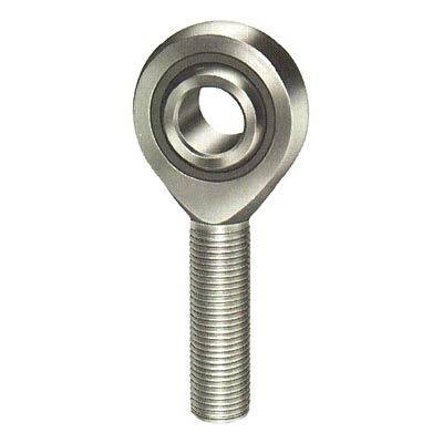

I really don't see that being much of a problem. The rear control arms only have one bushing on the forward leg of each arm. The rearward leg is connected to the subframe by what's called a Heim joint. (Also called a shperical rod end in some cases) It's like a ball joint, but with a hole through the middle of it for a bolt to pass through instead of a stud sticking out of one side.
Here's a picture of a few:
I don't see any way a polyurethane bushing can increase NVH more than one of those.
