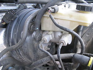

Are you saying that the power brakes on a Lincoln LS are vacuum powered? 'Hydro-boost' is mis-named since 'hydro' refers to water. But the more appropriate name, 'Hydra-boost', referring to hydraulic assist, seems to be much in evidence on MY LS. Is yours different?
And to 1Loud, my comment is focused on the fact that you rarely have anything positive to say. Practically every comment from you is 'dissing' something. Lighten-up, please!

Are you saying that the power brakes on a Lincoln LS are vacuum powered? 'Hydro-boost' is mis-named since 'hydro' refers to water. But the more appropriate name, 'Hydra-boost', referring to hydraulic assist, seems to be much in evidence on MY LS. Is yours different?...
Yes, my both of mine are vacuum, as are every other LS I've ever seen. The LS service manuals only show vacuum assist, and only vacuum boosters are listed as replacement parts. I'll be blunt. You're full of it on this.
(Post a picture to prove me wrong!)
I looked for it on mine too Joe and it is just vacuum. The only thing I can think is there may have been a mixup in terms relating to the electronic brake assist.
pretty much...
while sure the main part of the braking system is full of fluid and therefore hydraulic based, the assist part of the system is all vacuum just like the vast majority of cars on the road
just like when the engine is not running, and there is no vacuum in the booster, the brakes are hard as hell to push when it is just the hydraulic system alone
its not a hydra-boosted system (the boost doesn't come from the hydraulic fluid) the appropriate name would be a "vacuum assisted hydraulic system"
The problem is that there really are hydroboost systems (and some Lincolns used them in the past), but they are still pretty rare (for cars), and the LS never used one.
The vacuum diaphragm on most vacuum-assisted brake systems is a 7-12 inch diameter construct setting on the firewall where the linkage goes through. Where is it on a Lincoln LS?
KS

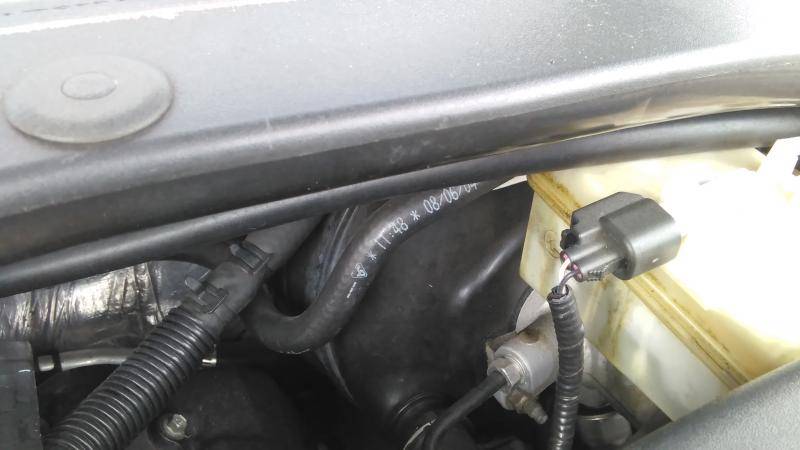

Dude, seriously go out to your garage and open your hood (just like I just did, to make sure I've havent been on drugs for the last three days and my life is a lie...) its right there exatly as you describe it would be, just like every single car that I have owned since I was old enough to drive.
it seriously is a huge ass black circle hiding behind the fluid container, you cant miss it, even if your are only using the OEM under hood light...

Same place, right behind the master cylinder.
Here's a picture from the web. You can see the upper left quarter of it.

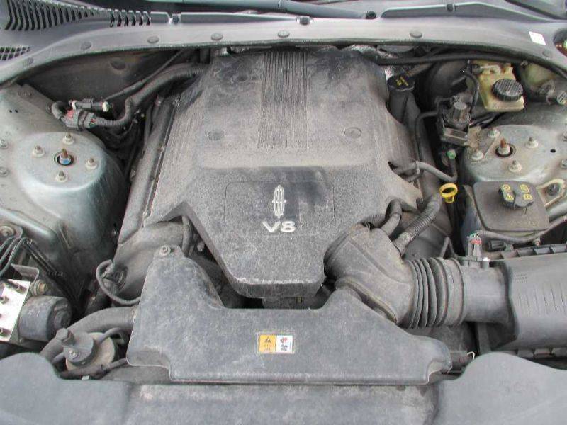

it can clearly be seen in this picture, from the right edge of the yellow on the oil fill over to the brake fluid reservoir.
