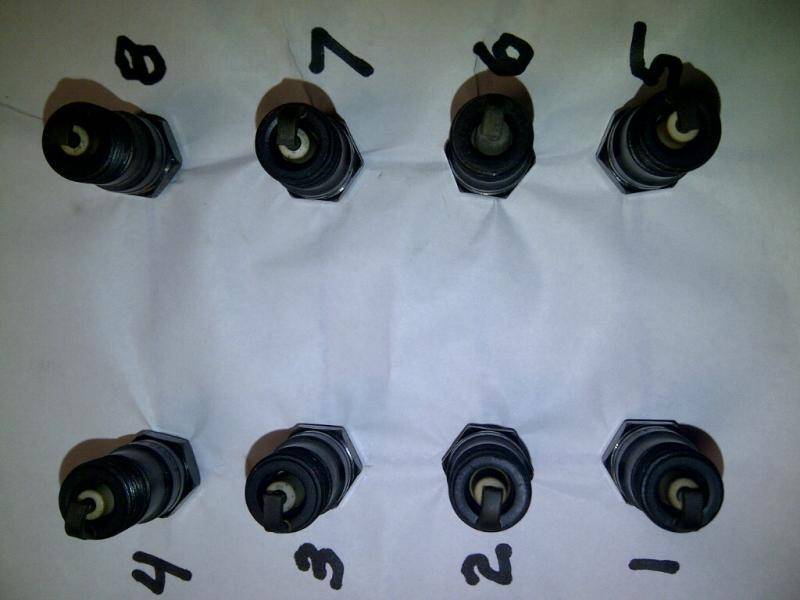

Help read these plugs...

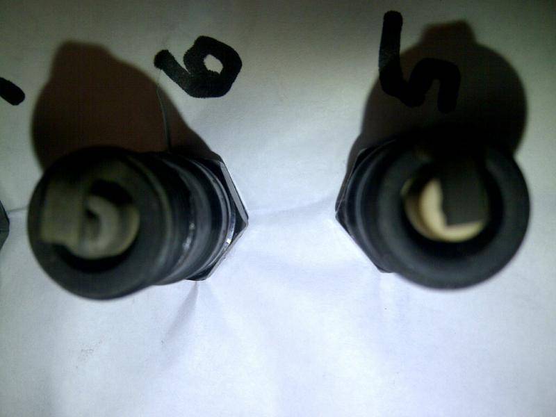

It's hard to read plugs used with unleaded gas, but #6 has issues, looks either quite rich or it's misfiring. Could also be oil, but without having the plug in my hand, I can't tell.
The rest look fine from here. ;)
I agree with you on #6.
It fits the symptoms too. Idle issues and occasional stutter at WOT.
Just not sure where to look. Plug wire or injector?

Start with the wire and change out the plug. If the symptoms continue, then swap two injectors.
You're running Coppers?
I'd swap in some new Ps, Delco has a new Plat out that I'm going to try, would also swap injectors 6 and 5 and see if that condition moves before buying parts

In your case, yeah #6 is significantly different in color than your other plugs. If you would like to know why, swap a wire/coil or an injector from #6 to another cylinder, and see if your problem moves with it.
The wires, plugs and injectors are all new, but I've had new parts go bad before. I'll start with new plugs and either swap wires or buy another set.
