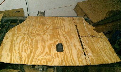

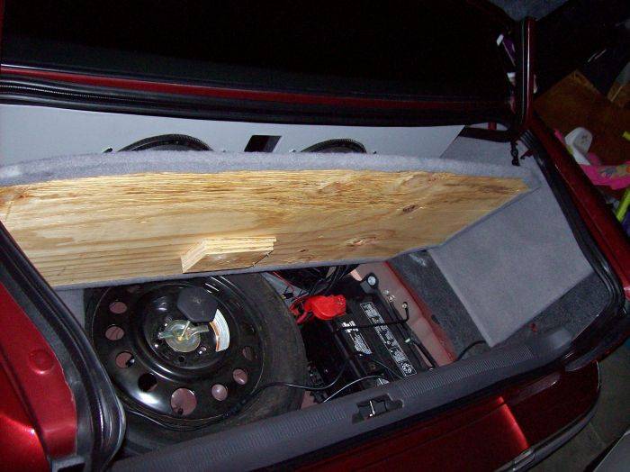

This is a simple, but effective mod I am in the process of doing that will make my life a lot easier and may help one or two members who are in relatively the same boat.
With the nitrous bottle going in soon, along with a 12 inch sub in a prefab box, I did not want to be in a position to always have to move those items in order to access the battery.

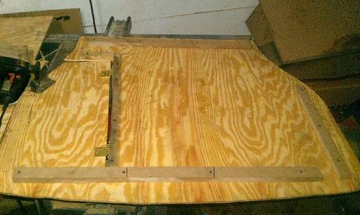

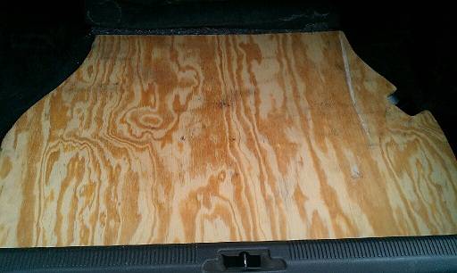

With that said, here are some pics of my answer to that obstacle. In short, a new spare tire cover with a hinged door for the battery area was made. A 1/2 sheet of 1/4 in plywood was used. 1/2 inch could be used but I was a bit concerned with the oem handle being able to hold that weight in it's "up" position. Initially, as you will see in pic 3 , we were only going to make the door for just the battery area but after thinking a bit it only made sense to make it longer in order to grant full access to the battery as well as the fuse box. At the bottom of the last pic, you will see marks on the brace where we were about to cut so that the front lays flush as the oem cover did.
It's is basically done except to lay 2 more braces, install a small handle for the battery door as well as spray some adhesive down and reapply the oem carpet. I can attest that it does lay as flush as oem and is will be very supportive of the weight without "bowing". The door opening is 21 and 1/4 inches long by 11 5/8 inches wide.
Hope you enjoy....

That looks like its going to work great. Do you have any pics with the carpet on and with it in the trunk? Or are you waiting to post pics of the trunk 'till you get the NOS bottle in?

Waiting til it is all installed so I do not have to keep moving the carpet. I will have final pics next Tuesday evening of the finished product.

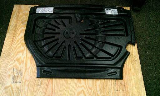

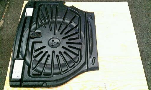

This is an awesome and simple mod. Now that yours is done I can do mine. I'm thinking of trying to use the existing plastic cover. I havent even looked at the cover that close recently to see if its even possible. I've been busy with my online classes and work. And I just put a brand new alternator in my LSE today. The $35 junk yard alternator took a dump after 2 or 3 months.
That was considered as well and it actually should work. The only reason I went with wood is if I decide to ever to take the nitrous out I could go back to the oem look and no one would ever know the difference.

Couldn't you have just cut, and put a hinge on the stock spare tire cover? Either way, looks good!
Yeah, i've never actually took the time to look at what material the stock ones are made up. Probably plastic I take it?

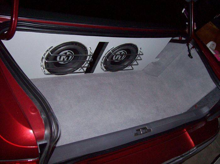

Creative thinking.:Beer How big is your sub box? Is the bottle to large to mount under the reardeck with thesub box? I thought of doing something like that. But my box wouldn't fit with the floor mat in place. So I removed the mat and made my own floor like you did. Thes are old pictures. Before I installed the amps on the floor. Made things easier. I am a little OCD thou. Get to the spare and the battery easier

Damn.... Thats got to suck. Its going to be a real PITA to get to the spare. Assuming you have to remove the bottle to get to the spare. Still creative thinking on your part. Looking forward to seeing the finish pictures.:)
