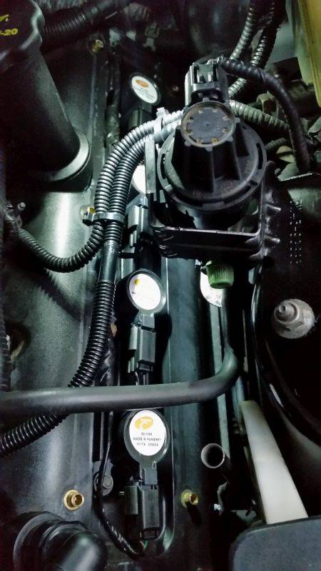

I can also tell you it's probably your coils, not your throttle body, particularly coil #4 by the PCM
this is my first guess. if you replaced your coils with cheaper aftermarket coils, you may have got a bad one (or two) right out of the box.

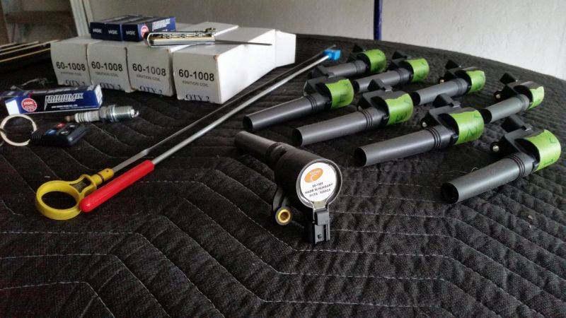

i used this brand .... NEW Araparts™ brand copper ignition coils with boots and springs...
i replaced all 8....car only has about 3 miles on it since i replaced them lol

As Frank said, your coil in position #4 is misfiring and the Electromagnetic interference is distorting the PCM causing it to store false Throttle Body codes. It'll run like crap and buck the transmission, ruin your CATs if you keep driving it like that.
Not a word of a lie ... I just went through this couple months back ...
you need to purchase 8 brand new OEM Ford coils along with 8 brand new NGK iridium plugs, gapped to 1mm and install those to resolve this problem.
I bought a 2004 LSE V8 for 1300$ that had that exact same problem which had just prior to that been to the dealership where they put on a new Throttle Body and position sensor to the tune of 2700$ and it still left the customer with a the same problem. They recommended a new PCM after that. Seller was very frustrated with it all. Just wanted to part with it and end the headache.
I knew of the coil #4 EMI/RFI to the PCM issue causing Throttle Body codes and Failsafe mode issue and bought it immediately.
Got it home, replaced coil 4 with a spare known to be good OEM coil and the problem went away instantly.
Followed by 8 brand new Visteon Ford coils and 8 NGK plugs, returned the car back to beast mode. Then fuel filter and couple of sea foam into half tanks to clean it out further.
When I pulled the old coils and plugs out, I found all sorts of different variances of plugs and coils. You can't half fast coils or plugs, here and there, they have to all be refreshed with OEM coils and NGK plugs at the same time. It's just best that way. Double, triple check your plug wells for leaks and ensure all coil connectors click firmly in place when installing new coils.

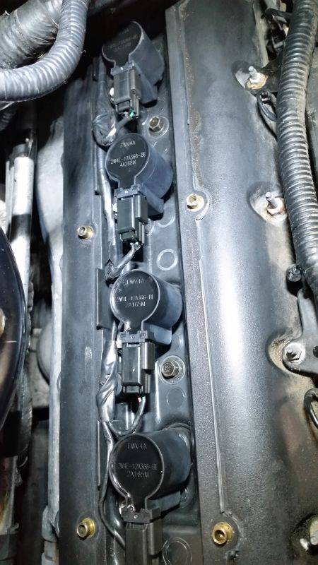

Took the Coil Covers off from the 04 LSE V8 with full intentions of swapping out all 8 coils and all 8 plugs.
So far found bottom most rear bolts not installed on either side since dealership work, (missing) included with that, a ton of gasket sealer applied on the top side of the covers in an attempt keep something out.
Going after #4 coil first, the one that is suspect and known to radiate EM interference towards the PCM (which is hiding directly behind the firewall nearby).
I see no evidence on Bank 1, that neither of coils #1-2-3-4 are upgrades, all seem original and have XXXXX-BE revision.
I do take notice of the newer looking coils on Bank 2, #5-6-8, 7 remains original.
Although the replacement coils end with an -BB revision, which indicate a lower revision from the original factory installed -BE. Not sure about that one <shrugs> I guess it's all what lays around on the shelves in the stock rooms I suppose.

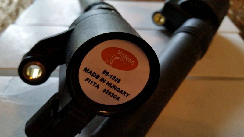

I grabbed one of those, went with the shiniest, prettiest one I could find and seated it in coil well #4.
bolted it down and clicked the connector in place.

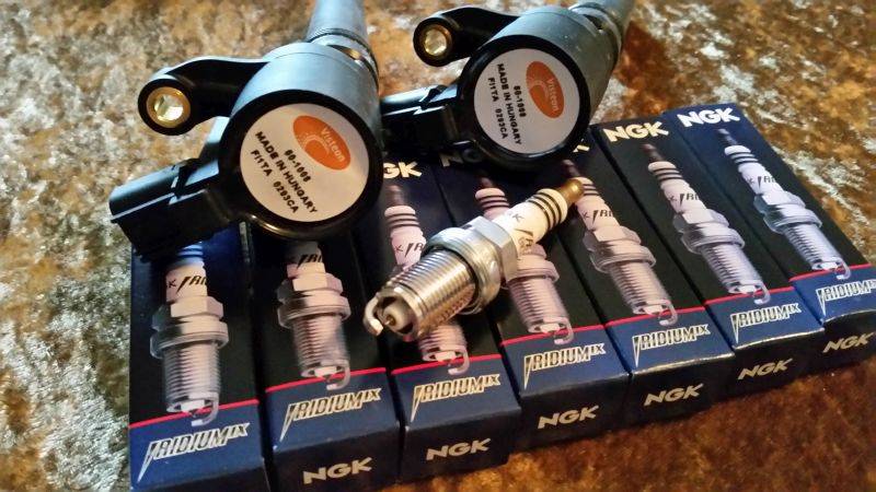

I'm saving my brand new Visteon's. I'm going to move some of the coils around and put the new NKG plugs in but that's all for now.
Any further misfires, I got a whole box full of known-to-be-good working LS coils.
That idea might change but for now the Visteon's stay on the shelf, if anything they'll go in my 01 and I'd share those relative new Motorcraft OEM coils with the 04.

Pains me to separate with these nice Visteon coils. Can't get them anymore. Paid 220$ for all 8 couple years back.

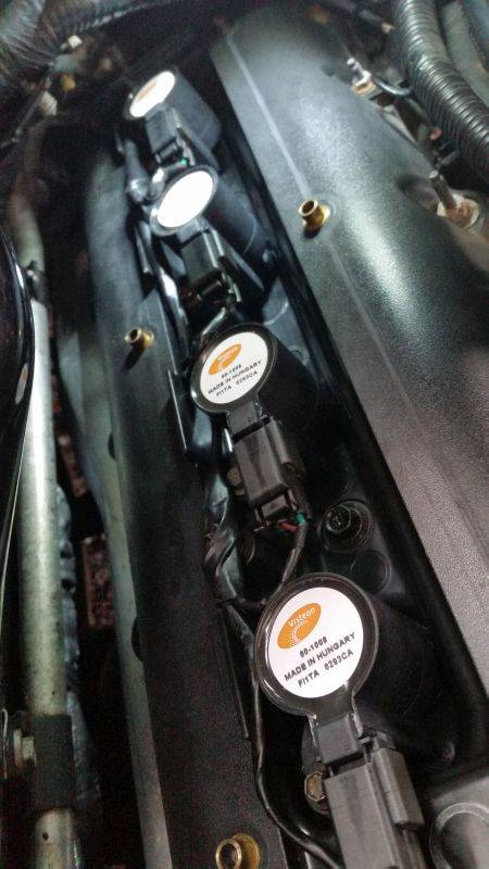

Passenger side, #4 was bad causing ETC fail safe mode. Original coils and #4 had Motorcraft plug while others had NKG GP's, below OE standards and all where over gaped. No oil or water in any of the plug wells.

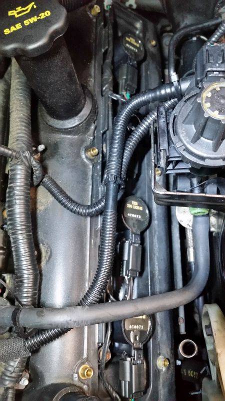

Drivers side, all but #7 had fresh coils, all had NGK GP's and over gaped. #5 seemed to give a misfire code on WOT. No oil or water in any of the plug wells.
Labeled all the removed coils, throwing #4 in the garbage, keeping others as known-good spares. Labeled #5 with a question mark.

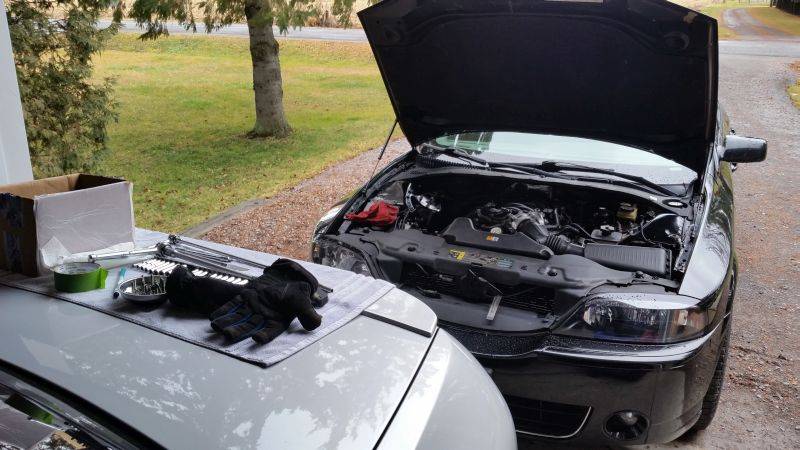

Little damp and humid to be doing this outside but the princess is taking up all I got for a garage.
Passenger side completed, all cleaned up, fresh coils & Plugs.
Drivers side completed, all cleaned up, fresh coils & Plugs.
All done, coil covers will go back on next week, want to give them a little color first. Car not being driven.
All in all, the dealerships threw a Throttle body & position sensor at it and informed the PO he would need a new PCM next.
ETC failsafe mode, P2107 and P2110 was due to failure of coil #4 freaking out the nearby PCM, ran like crap, after replacement of coil #4 with a used coil, problem resided but still overall a terrible idle. You could hear and feel it as it idled, WOT threw another misfire code on another cylinder.
All new top of the line coils and plugs gaped correctly with some di-electric grease in the boots cleared everything up!

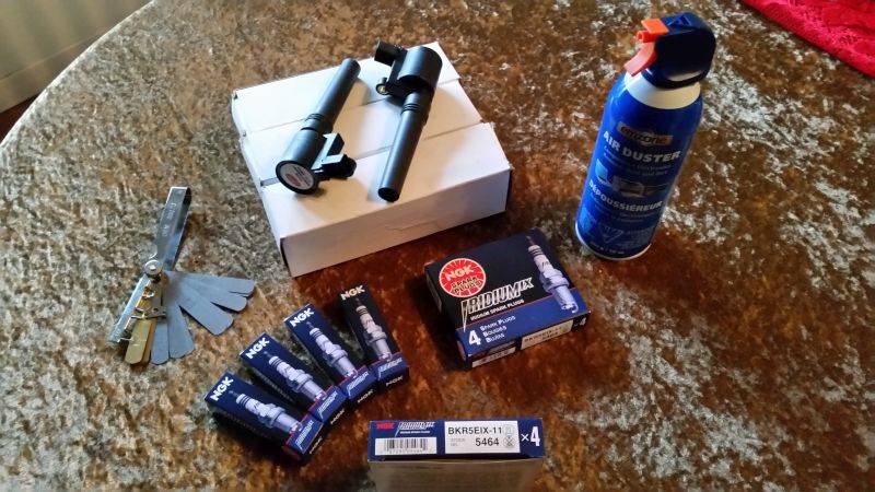

hey joegr, i was wrong with the part number for the plugs... will these work??
8 Genuine Motorcraft Spark Plug SP-497 SP-467 AGSP32FM
Found a ebay account for 399 shipped for the coils and the plugs. Coils where dg 529, so i know im good with them from your previous confirmation.

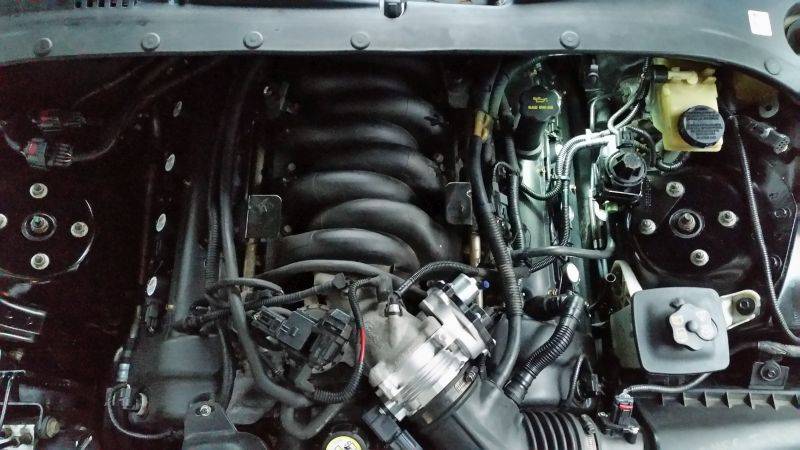

As for the car, little update...my mechanic did some further trial and error. He removed the ARAPARTS coils from cylinder 4 and 3, because his new computer/scanner that he just bought showed that they where actually not even firing and those cylinders where not running basically at all. He looked through the old coils that i we took out the car, and realized half where OEM motor-craft, and the other half generic, like basically what i was putting in it. He put two of the used motor-crafts in 3 and 4....and pretty much he told me that all those codes when away. He said the car didn't act up going in reverse upon initial startup like it sometimes did, and it pretty much ran fine down the street. He said the only code that was still on now was a misfire code, but he said that can easily be from him playing around with the plugs and coils moving them around to get the car to run correctly. I forgot to say that he took out all the aftermarket plugs too to check all gaps to make sure they were 1mm........sooo he basically said the "info here" is leading in the right direction and for me to go ahead and order the OEM coils and plugs... fingers crossed****
Thank you guys so far....oh, here is a pic of the car...figured i show you guys since your helping so much....
