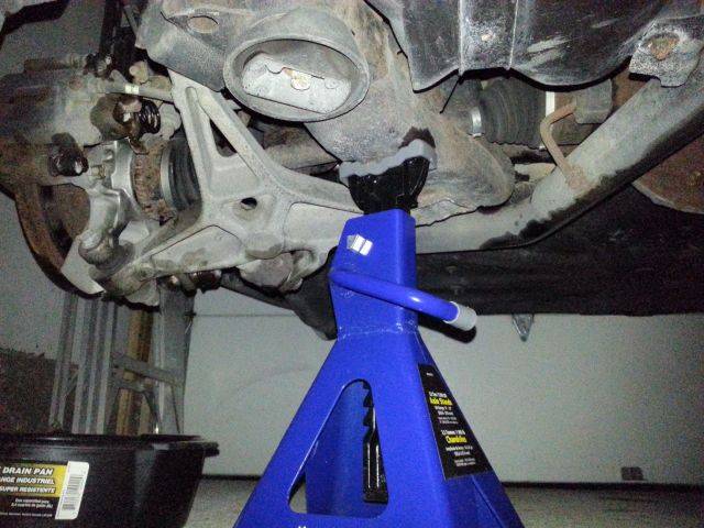

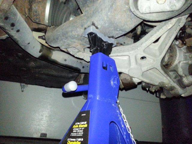

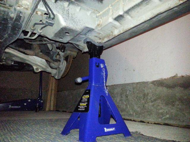

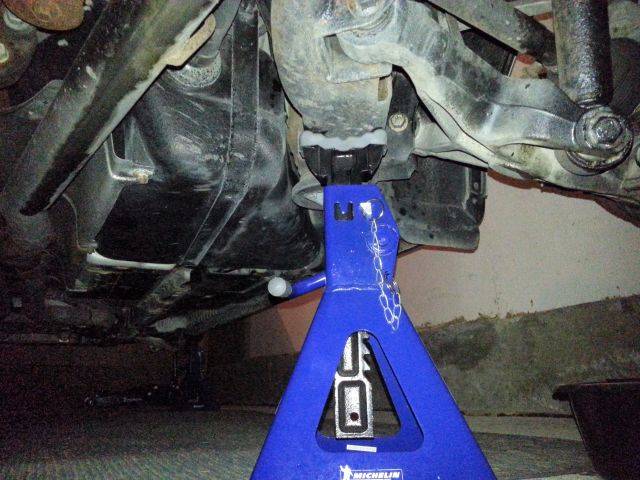

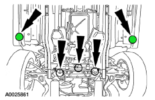

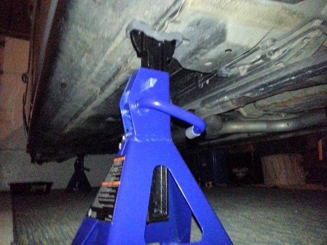

Where do you jack from then? My driver's side is fine but the passenger side caved in a little. I don't know if I missed the jack point or what, but the taller flange folded flat so now it's level with the cutout for the factory jack. It jacks fine though... (for now)

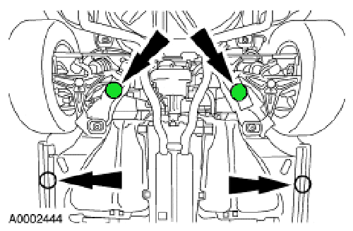

Where do you jack from then?...
FRONTS
Left Front ... (drivers side)
Right Front ... (passengers side)
REARS
Left Rear ... (drivers side)
Right Rear ... (passengers side)
Rear facing
LS4ME once posted something like this and I made note of it at the time.
I tried the old piece of wood with a slid cut into the center method once but I was a dumb dumb and cut with the grain as apposed to against the grain,
the car settled and snapped the wood piece in half. I could redo but I'd rather get something like you posted in that link above.

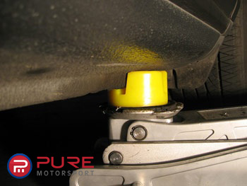

I could also see myself trying these pucks type units,

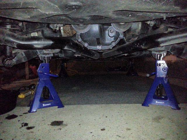

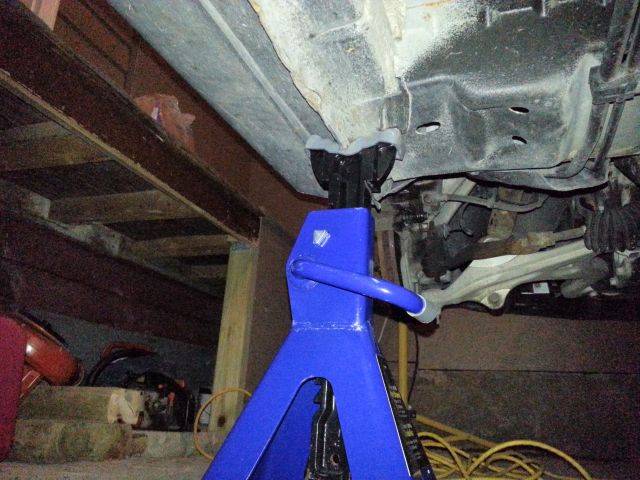

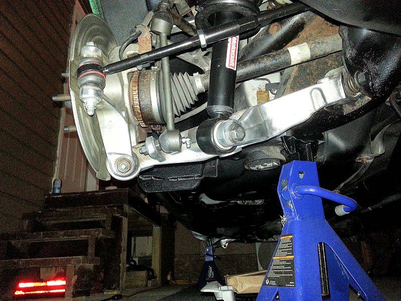

When I first got my LS I of course started to lift at the rear point as the OM mentions, your typical place, if you will.
On the first few cranks of the jack, I could hear it give and make some noises I did not enjoy. Immediately stopped.
Didn't seem to collapse or anything but I knew there and then, it's not were I would continue to lift this car.

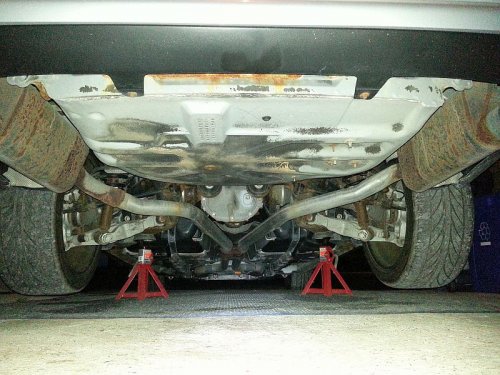

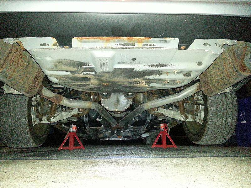

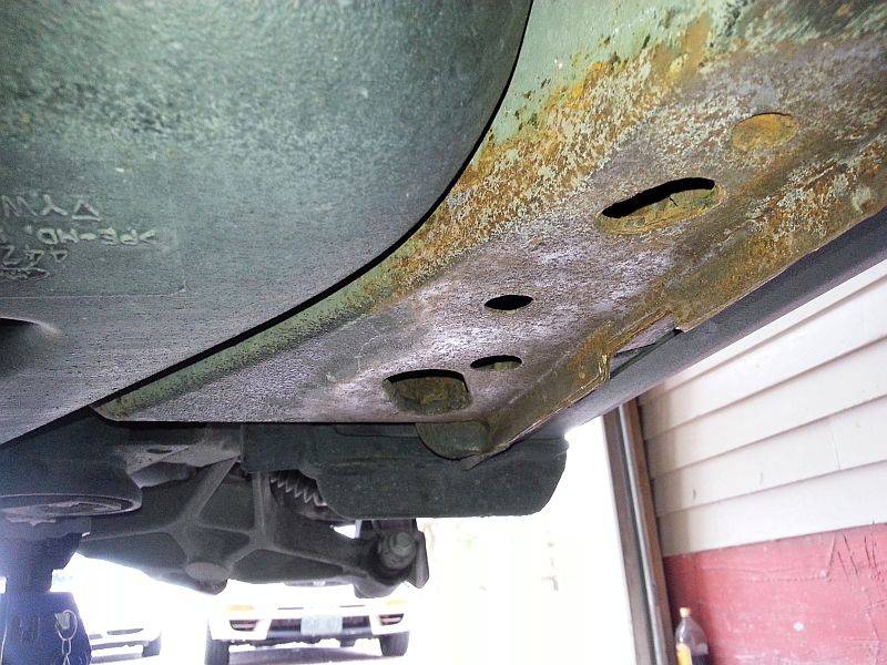

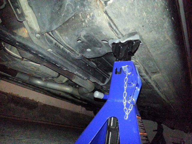

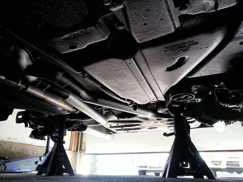

You can see in the above pic, (drivers side rear) the Canadian rust got to it already, mind ya this is where I already have it up in the air and on the 1st pass of my undercoating project. That pic already shows where I've passed the steel wheel grinder once over it to see where it was at.
After that I always now lift from the most rear points. I don't need to collapse it below the dog leg if I can avoid it.
Sorry for the pic whoring, (just love pics)

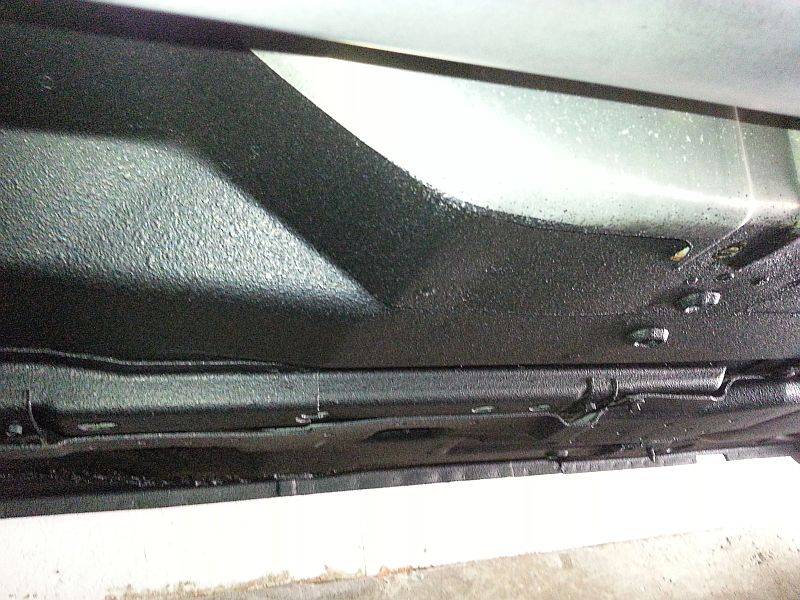

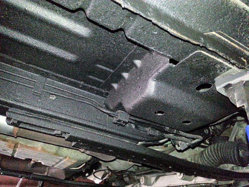

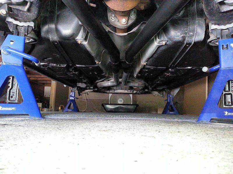

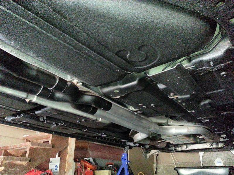

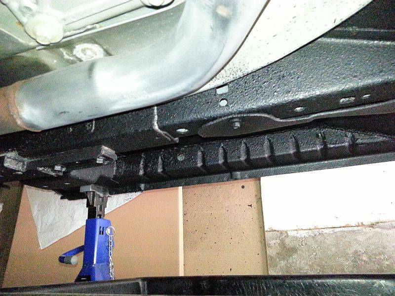

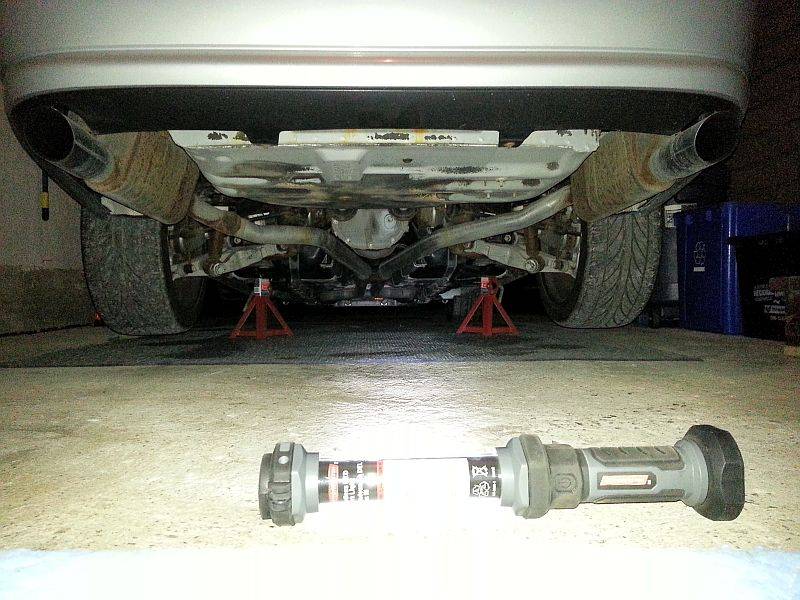

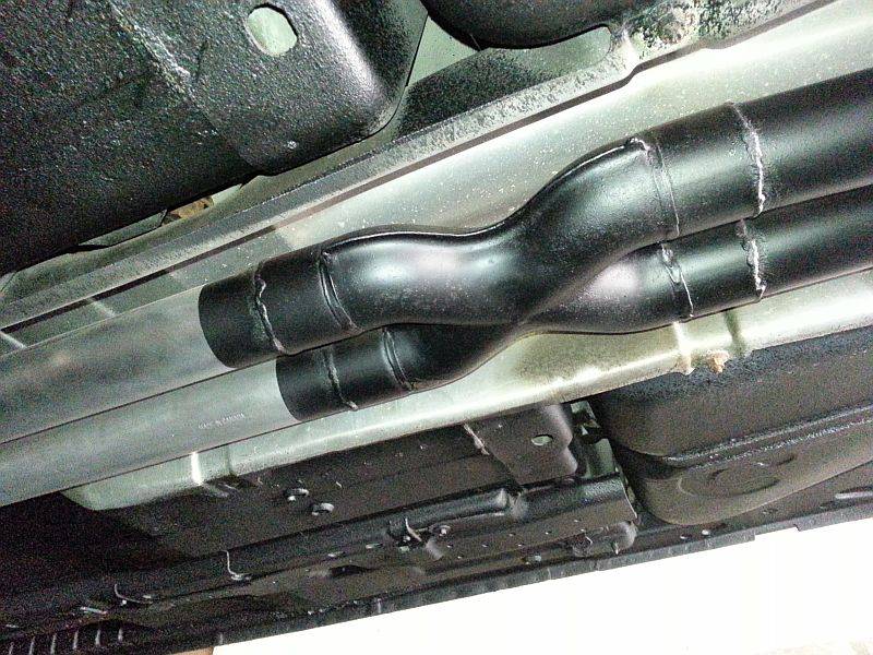

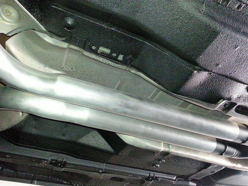

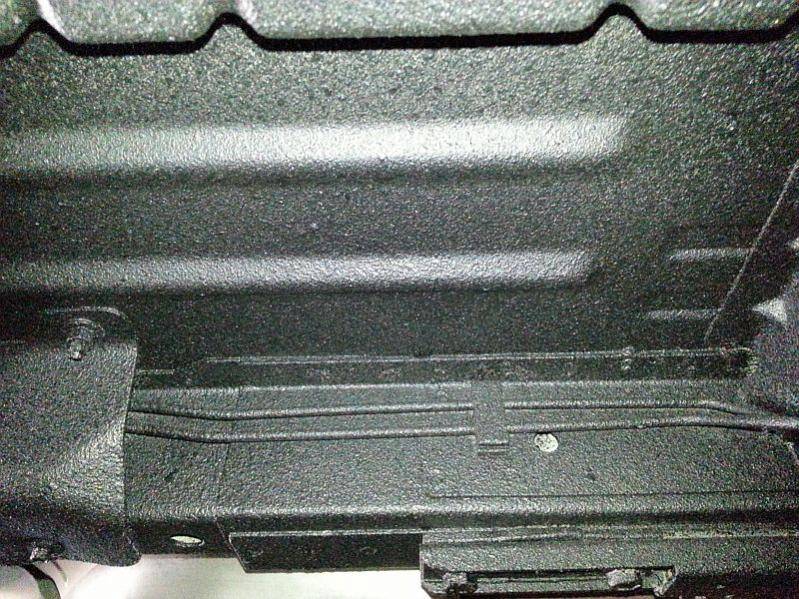

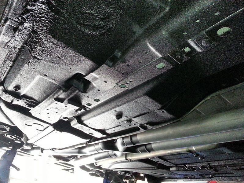

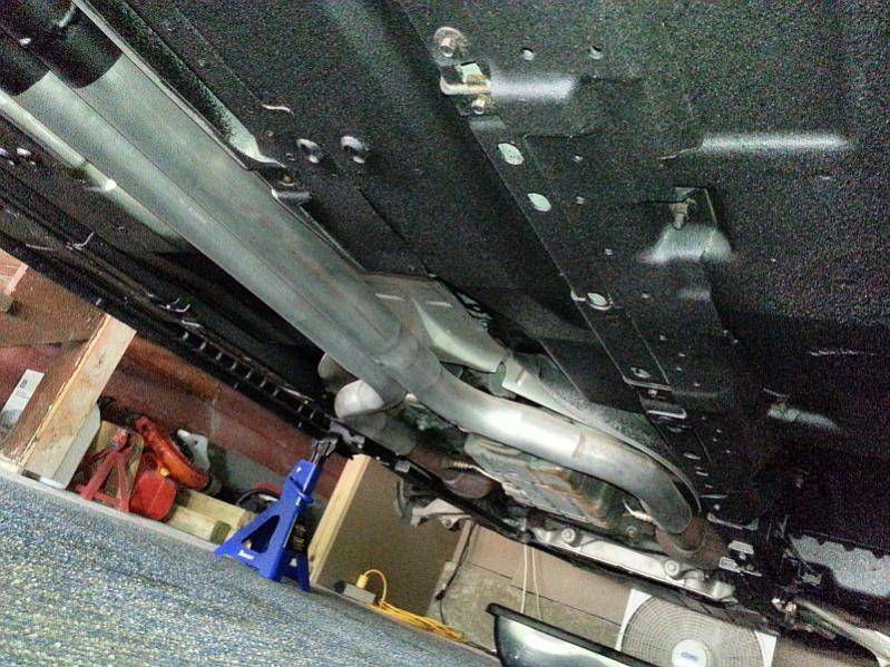

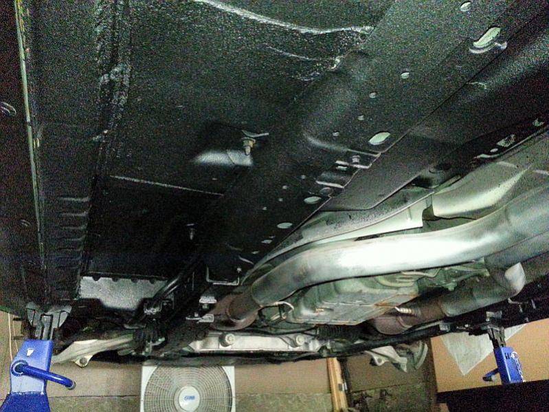

My undercoating project, the idea was to remove as much as possible surface rust on the entire underneath side of the car while it was up for suspension and brakes rebuild.
Although not badly covered in rust all throughout, it was mostly the back of the underneath near the rear where most the surface rust was present.
Didn't get it all but by the time I had gotten up inside the wheel wells and all throughout the underneath, I figured I was that much further ahead.
It does not see winters at all while in my ownership, I did drive it I think March, April when I first got it a few years back but never again since.
Looked like this, underneath at one point.

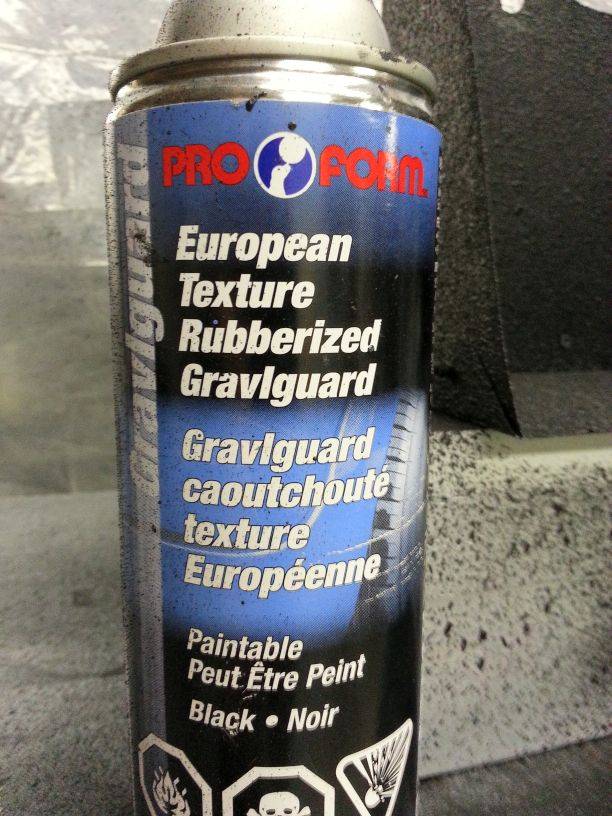

Used a few cans of this stuff on it.
Hope you can all understand and appreciate I spend a couple of days going at it, several passes with all sorts of steel wheels, grinders, sand paper and such to get as much off as possible before covering it.
I did not just spray it with the coating (over rust) to get this result,
