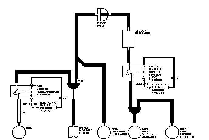

I suggest starting by familarizing yourself with the vacumn lines...
The plastic fittings are the predominant suspects.

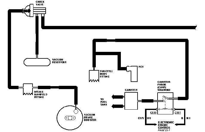

Do you have any clue on what the lines going to the gas tank are?
I remember something snapping off the gas tank when I went to install the fuel pump but didn't know what it was so I never replaced it. I think it plugged directly into the fuel tank. This wouldn't be the cause of the vacuum sound on the top of the engine though.
Is there anything I can spray around the engine to find a leak, sort of like the dye they use for AC leaks or soapy water for the air bag leaks?
You should have Canister Purge lines going back to the fuel tank. They are part of the EVAP emission control for fuel vapor control.
