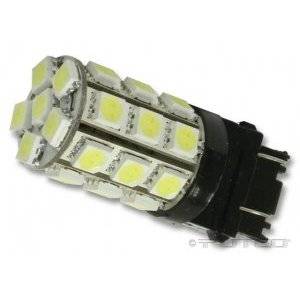

I just ordered these bulbs and the base is too long to fit in the adapter. They are 3157. What's the problem? Thanks.

I'm sure they are 3157 and yea i looked at the auto replacement guide at www.sylvania.com and it said 3157. I have a 2005 LS.

The OP need only post a picture of the bulbs that he removed to clear this up.

Thanks for pics. I ordered a couple from superbrightleds. So, what difference does a one filament vs two make?
bulbs need to have two filaments if they need to have two different brightnesses, such as one light fixture that functions both as a brake light and a parking light
Post a link to the ones you bought. I have vleds as reverse lights and they work fine. They look just like the ones you posted
