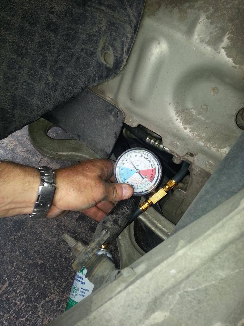

Ok I checked the pressure on the AC lines with help from my father in law.
Engine Idle, it was 74 pounds. Then I reved the engine to 2500 RPM, and it dropped to 20 pounds.

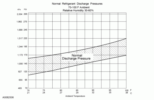

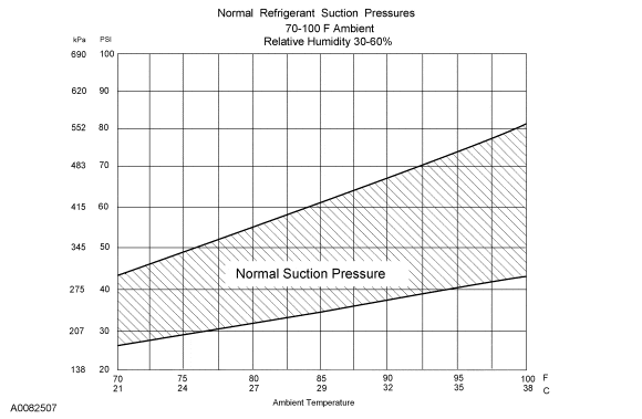

I don't know if this will help.......
Procedure 1 — Ambient Temperature At or Below 38°C (100°F)
NOTE: The system performance can be evaluated and diagnosed by analysis of the compressor suction and discharge pressures. The following procedure is used to determine if the system is operating at normal pressures.
NOTE: The procedure varies depending on the ambient (shop) temperature. If the ambient temperature is 38°C (100°F) or lower, follow procedure 1. If the ambient temperature is over 38°C (100°F), follow procedure 2.
NOTE: If the A/C compressor cycles at any time during this test, refer to the diagnostic table.
Drive the vehicle or run the engine until it reaches normal operating temperature.
Connect a manifold gauge set or refrigerant service center with high-pressure and low-pressure gauges to the refrigerant system.
Set the climate controls.
If equipped with manual climate control, set the A/C controls for normal A/C-PANEL mode, full COOL temperature, FRESH air, HI Blower. If the vehicle has a fresh air/recirc button, set it to FRESH. If the vehicle has an A/C switch or compressor on switch, set it to A/C ON.
If equipped with ATC, set temperature to 15°C (60°F) (lowest possible temp setting) with the dual function disabled (if equipped). Manually set blower on high. If the vehicle has a fresh air/recirc button, set it to FRESH. If the vehicle has an A/C switch or compressor on switch, set it to A/C ON.
If the vehicle is equipped with auxiliary climate control, set the auxiliary controls to full COOL in the PANEL mode at HI blower speed.
Open all vehicle windows and leave the hood open for the test. Open the rear hatch and/or rear doors (if equipped).
Confirm the compressor clutch is engaged and the engine cooling fan(s) are operating or engaged. Allow the vehicle to idle until the suction (low-side) and discharge (high-side) pressures are stable or fluctuate in a range that repeats.
Record the ambient (shop) temperature.
Record the discharge pressure. If the pressure is fluctuating, record the average value.
Determine if the discharge pressure falls within the normal operating limits using the Normal Refrigerant Discharge Pressures chart.
Record the suction pressure. If the pressure is fluctuating, record the average value.
Determine if the suction pressure falls between normal operating limits using the Normal Refrigerant Suction Pressures chart.
Proceed to the diagnostic table.

74 at idle is too high. 20 at 2500 RPM is a too low. Unfortunately, I really can't tell you much without seeing the high side pressures at the same time. (That's why I linked to a gauge set.) I'm thinking bad compressor, but then I don't have much to go on here...

We tested on the Mothers brand new Journey. It would drop to 20 psi when I revved to 2500 RPM, but on its own it would climb back up to 50. Shortly after it would drop to 20 psi, then return to 50 and do this while still keeping it under 2500 RPM.
My LS also drops to 20 PSI when revved at 2500 rpm, but unlike the journey, my LS remains at 20 psi while under 2500 rpm.
I am not sure if that means anything.
I'm trying to give you the data as best as I can. What do you mean "seeing the high pressures at the same time"?

The AC system has two distinct sides, the low side and the high side. You are giving the pressures for the low side (suction side of the compressor) only. To really know anything about the system, you need the pressures for both sides at the same time. That's why the AC pressure gauge sets have two gauges and a high side and a low side connection.

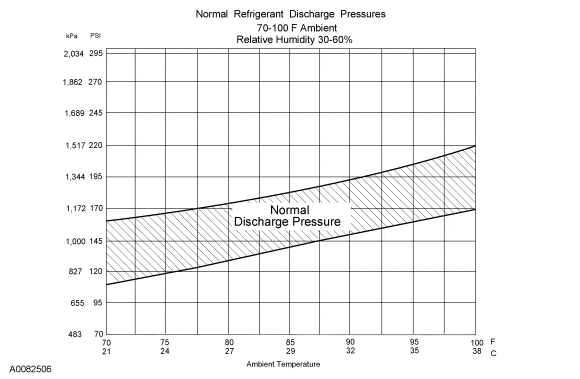

I just charged the system last night and the pressures don’t quite jive.
30psi low / 205 psi high at idle ~90F outside.The system took 40oz which felt high so we removed some to bring it down to 34oz. The high side is right on as it increased and dropped accordingly with ambient temperatures.
The air is coming out ice cold at 37-38 degrees while cruising.
I just can’t figure out why the low side is down about 10 psi from what it should be. I did the electric fan conversion and it’s pulling good air and everything was replaced, compressor, condenser, THX valve and evaporator. Thoughts?
...30psi low / 205 psi high at idle ~90F outside.The system took 40oz which felt high so we removed some to bring it down to 34oz. The high side is right on as it increased and dropped accordingly with ambient temperatures...
Wow, that is way overfilled. Too much is even worse than not enough. The correct amount is 28 oz.
At 90 outside, you should see 150 to 190 PSI on the high side, and about 37 to 66 PSI on the low side. This is with the blower on high, set to fresh air in, and all windows open. I think on the 1st gen you are also supposed to have the engine above idle during the test.
With the correct 28 oz refrigerant + 7 oz oil, if the high side pressure is too high, it's an indication that the engine cooling fan is not moving enough air. The low side pressure being too low (with high side being high) is usually an expansion valve problem. That said, as long as it is cooling well, then being a little low on the low side is not that bad. I know that the BWM that I had called for lower low side pressures, and it cooled very well.
Yep, it was still overfilled. Pulled out 5 more oz to 29 and it sat at 36 and 185
