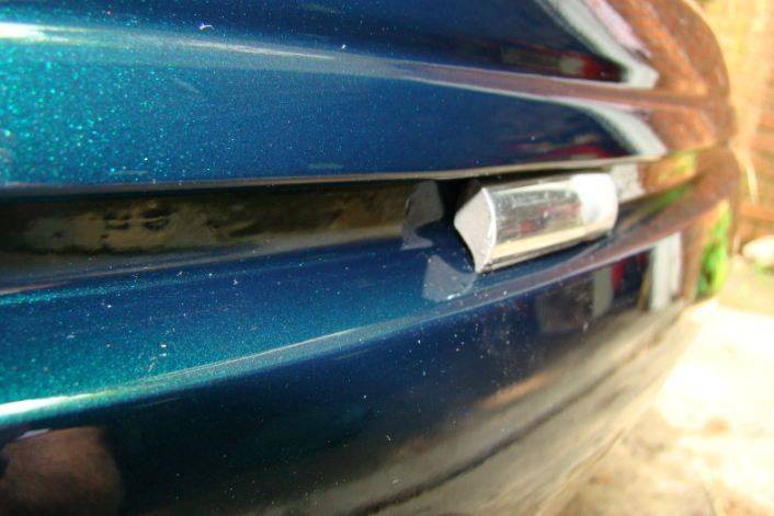

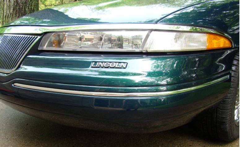

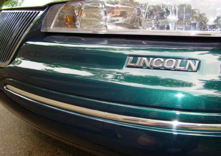

I replaced the chrome strips on my bumper today.

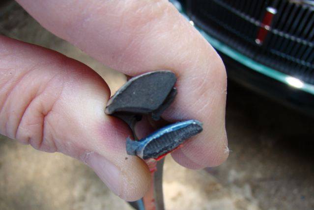

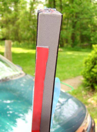

They don't make the original part anymore. The part I used is flat on the adhesive side. That works fine for the doors and quarter trim, but the original bumper peice is angled on the adhesive side.
The strip I used is a Flexi Chrome part HR018C.
Here's some photos. I tried to show the difference between the original and the flat one, and how it fits in the bumper channel.
I just split a length of double sided tape and put each half on each strip, to act as a shim to angle the strip properly, or at least, close.:)

looks amazing to me.

How well does the bumper stuff stay in if the original is angled and this isn't?

Yes that's true, there is not the same adhesive contact as the original.
The strip does fit into holes in the bumper at the ends, and the whole thing is in the channel, so I'm not too worried about it falling out. Time will tell though, and I can always re tape it.
