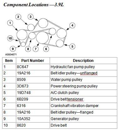

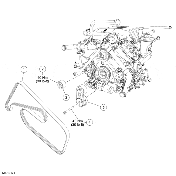

Hate to bring revive such an old thread, but here it goes. My factory serpentine belt on my 2002 LS V8 needs to be replaced and I was going to go ahead and replace the two idler pulleys, and either the complete tensioner or the tensioner pulley.
Have part numbers for the idlers then I saw and read the TSB 8-16-05 for a revised idler pulley. Based on the diagram in that TSB, I am somewhat confused on why you have to remove the tensioner to replace the idler pulley? Does that revised idler pulley replace the pulley on the tensioner or one of the other two idler pulleys (flange and unflange)? Just trying to make sure I order the correct parts.
As always thanks everyone.
I don't have a 1st gen, so what I say should be considered suspect...
I believe that the pulley on the tensioner is the same part as the idler pulley that is item #2 in post #2. Of course, my memory on this could be wrong.
That said, it's probably safer to replace the whole tensioner assembly as the spring may be getting weak by now.
So I need to get the revised pulley for # 2 (to replace the older unflange version), the #8 flanged and a new tensioner (and hope it has the revised pulley), and the belt :)
