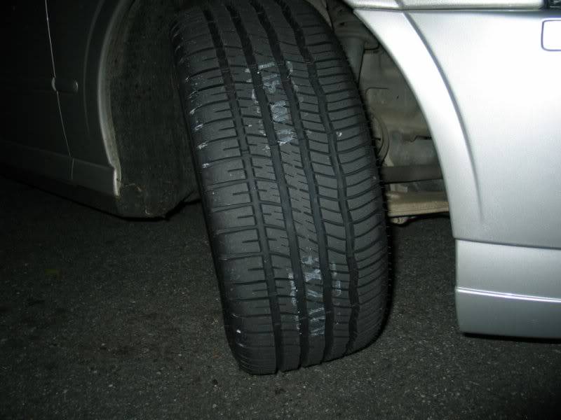

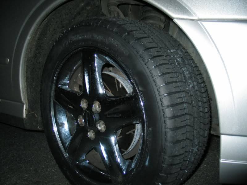

now with pics...
Finally got the second tire properly mounted. Well, It's mounted. Was it done properly? probably not. :p About 80psi finally did the trick to seat the bead. I was tired of F'in with it and didn't care one way or the other if it blew up. Anyway, its cold, and dark, some cruddy quick pics for the time being. Yes it's dirty, don't remind me. :D
Now the screwed up thing is. These tires are tough as hell, they feel hard as rocks, but they ride BETTER than the old ones, which were much softer and much more pliable. Road noise is practically non-existent. And I thought the alignment was out, but with these on the car tracks straight as an arrow. Who knew?

What size is that. The 255/45/17s I have still have some tread left.

255/45/17. The "lip guard" is pressed tight up against the wheel all the way around. Looks pretty good that way IMO. I put one of them on the balance machine, and after adding about 4 weights and it telling me to add more and more each time I just said screw it and stripped them all off. The other wheel is bent slightly and doesn't really balance anyway. Feels exactly the same with no weights as it did on the old tires that had over 240 grams on one wheel, and about 65 grams on the other.

I have the same wheels as you, do your wheels have corrosion where the cap snaps in? That will surely cause issues when balancing. At least that was the scoop with mine. I also had to chisel off the chrome and draw file the face where it sits on the rotor. Then once i get a decent balance, I tighten all the lugs by hand until I can't go any more, then inch my way around about 5 times torquing a little more each time to make sure the wheel sits flat- otherwise you feel that too. Love the looks of the wheel but can't wait to get rid of them.
As for balancing, if you don't have corrosion, try remounting the wheel on the machine after you install each weight. You'll never get the same reading twice but as long as its close, you should be all set. My wheels also don't run quite true so I get a slight shake from 75-80, but is otherwise fine. You don't feel it on the stock tires because the sidewall absorbs it all. I run at least 35 psi in mine.
