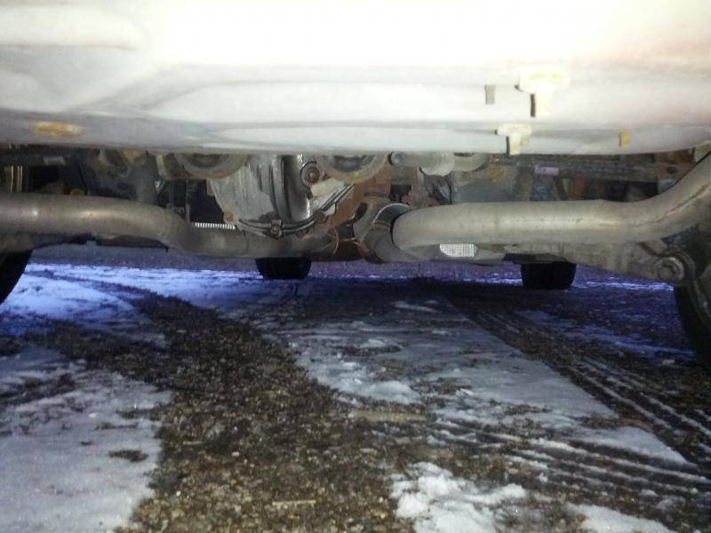

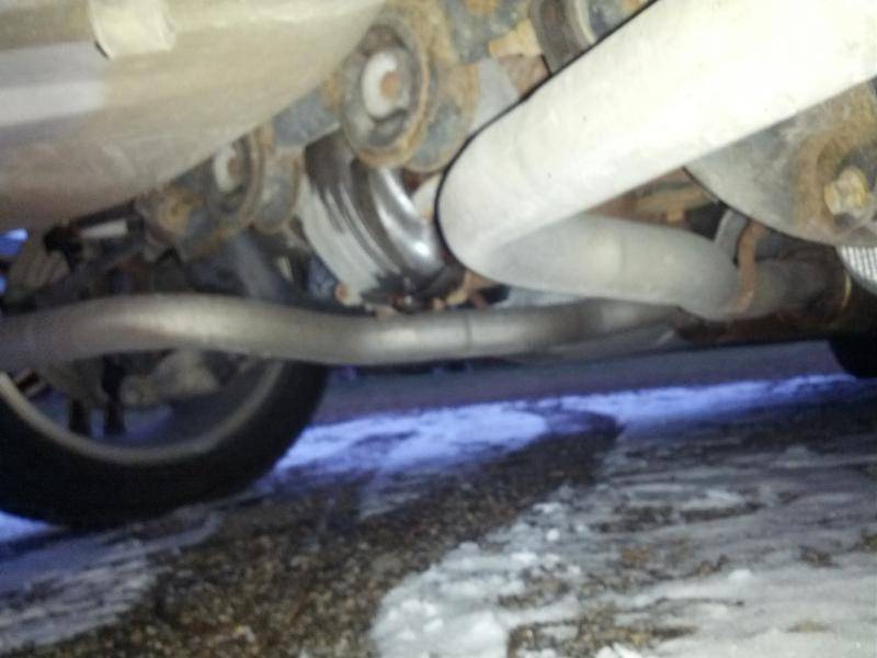

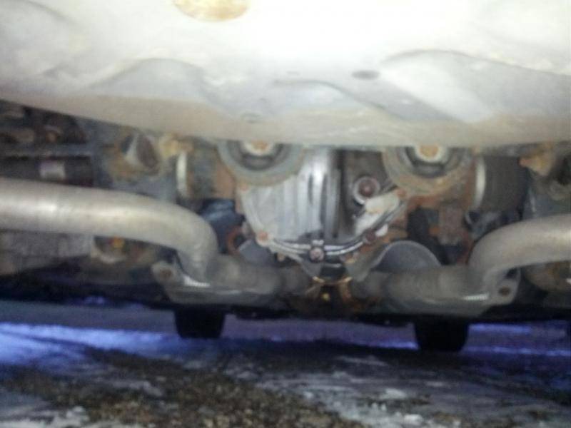

Dec 25, 2012 #1 S stugots Dedicated LVC Member Joined Aug 19, 2012 Messages 968 Reaction score 26 Location Michigan Noticed a couple drips in my driveway. This is all I can see. Is this a half-shaft seal leak or something else? Sorry for the fuzz.
Dec 25, 2012 #2 joegr Dedicated LVC Member Joined Dec 10, 2005 Messages 21,603 Reaction score 2,388 Location Gulfport Differential.
Dec 25, 2012 #3 S stugots Dedicated LVC Member Joined Aug 19, 2012 Messages 968 Reaction score 26 Location Michigan Yes I know. Does it look like the seal on the pumpkin?
Dec 25, 2012 #4 Ancillery LVC Member Joined Aug 7, 2011 Messages 34 Reaction score 0 Location Las Vegas I was almost going to suggest a doctor with a thread title like that. XD
Dec 25, 2012 #5 D DANRS112 Active LVC Member Joined Oct 23, 2012 Messages 126 Reaction score 4 Location Tampa stugots said: Yes I know. Does it look like the seal on the pumpkin? Click to expand... Considering how high the leak appears to be I'd say yes. Could always clean it up and see where it shows from first I guess.
Dec 25, 2012 #6 joegr Dedicated LVC Member Joined Dec 10, 2005 Messages 21,603 Reaction score 2,388 Location Gulfport stugots said: Yes I know. Does it look like the seal on the pumpkin? Click to expand... That or the fill plug.
Dec 25, 2012 #7 S stugots Dedicated LVC Member Joined Aug 19, 2012 Messages 968 Reaction score 26 Location Michigan Is the plug on the passenger side?
Dec 25, 2012 #8 S stugots Dedicated LVC Member Joined Aug 19, 2012 Messages 968 Reaction score 26 Location Michigan Ancillery said: I was almost going to suggest a doctor with a thread title like that. XD Click to expand... lol Dr. Cosmo Kramer.. Proctology.
Dec 26, 2012 #9 S stugots Dedicated LVC Member Joined Aug 19, 2012 Messages 968 Reaction score 26 Location Michigan Ended up being really dirty fluid making it boil up through the bleeder vent.
