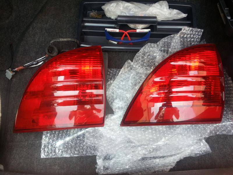

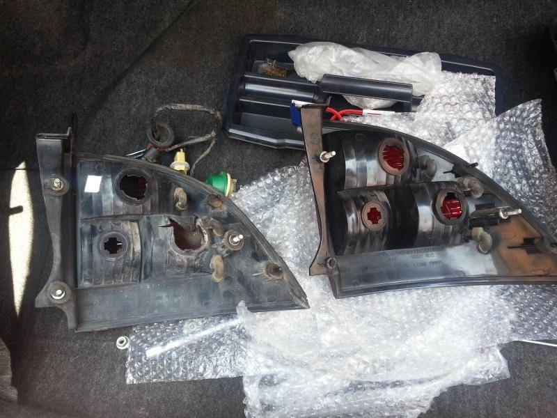

I replaced one light, it was totally cracked and melted.

some times i had to replace the bulb when i realize the problem. I had no time to buy i newone(usedone in good shapae,minor details) until a pal made a trip and brought me the light.
-I'm not sure if it was sticking, but some times i touched the housing lights and it was unusual hot ,that was how I noted the cracked one, the other side is in good shape as far for some darkness spot result of water leak into(now dry and sealed).

fabrizio, that is melted damage from the bulb not being seated correctly, it wasn't turned in 100%, popped loose and leaned up against the plastic, then when you run your brakes the bulb gets twice as hot and slowly begins to deform the plastic housing at the connector base. Bulbs go in and turn tight on a gasket, anything other then that will result in melting plastics over time. (bulb leans or gets too close to plastics)
