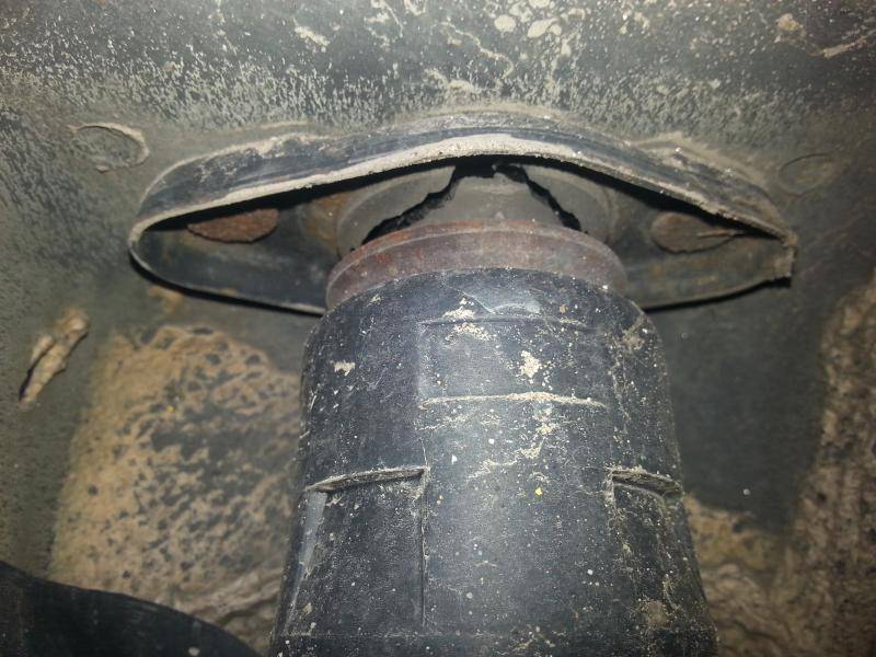

Your shock mount(s) in the trunk are probably disintegrated, letting the whole thing flop around back there. It's an integral design so you either need to cough up about $200 a shock for the specific Motorcraft shock unit if you can still find them or buy some Thunderbird/Cougar shocks for $20 each and then buy a retrofit mount kit from 98lincmk7lsc for about $60.

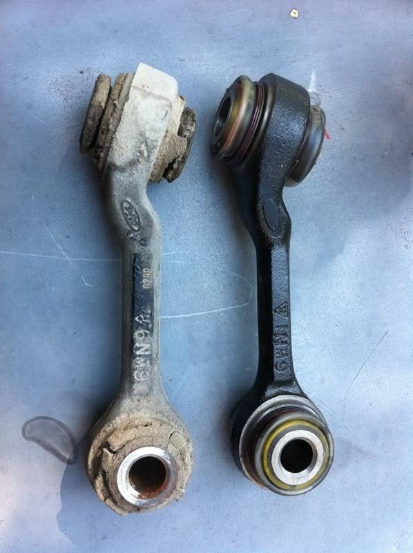

take a look at the rear "toe link compensators"
they help hold the toe of the rear control arms.
if yours look like the ones on the left, you might need new ones.

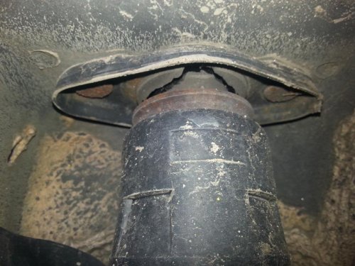

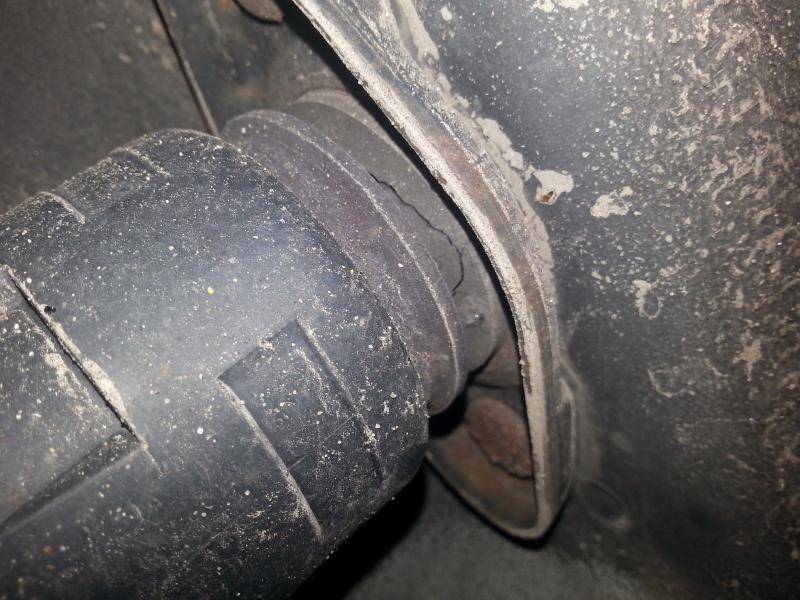

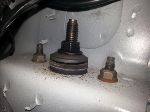

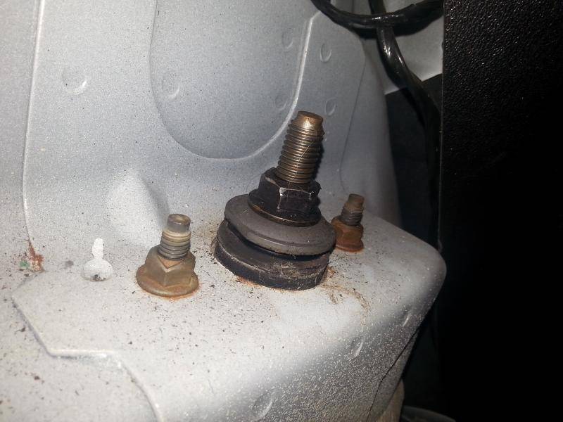

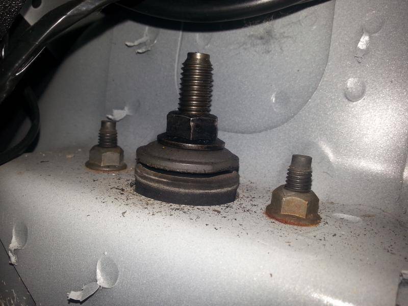

Just to share, this is how they look
Passenger
Driver
Obviously they look far worse on the outside.

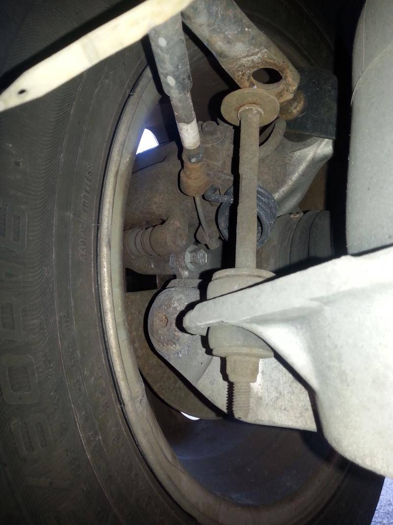

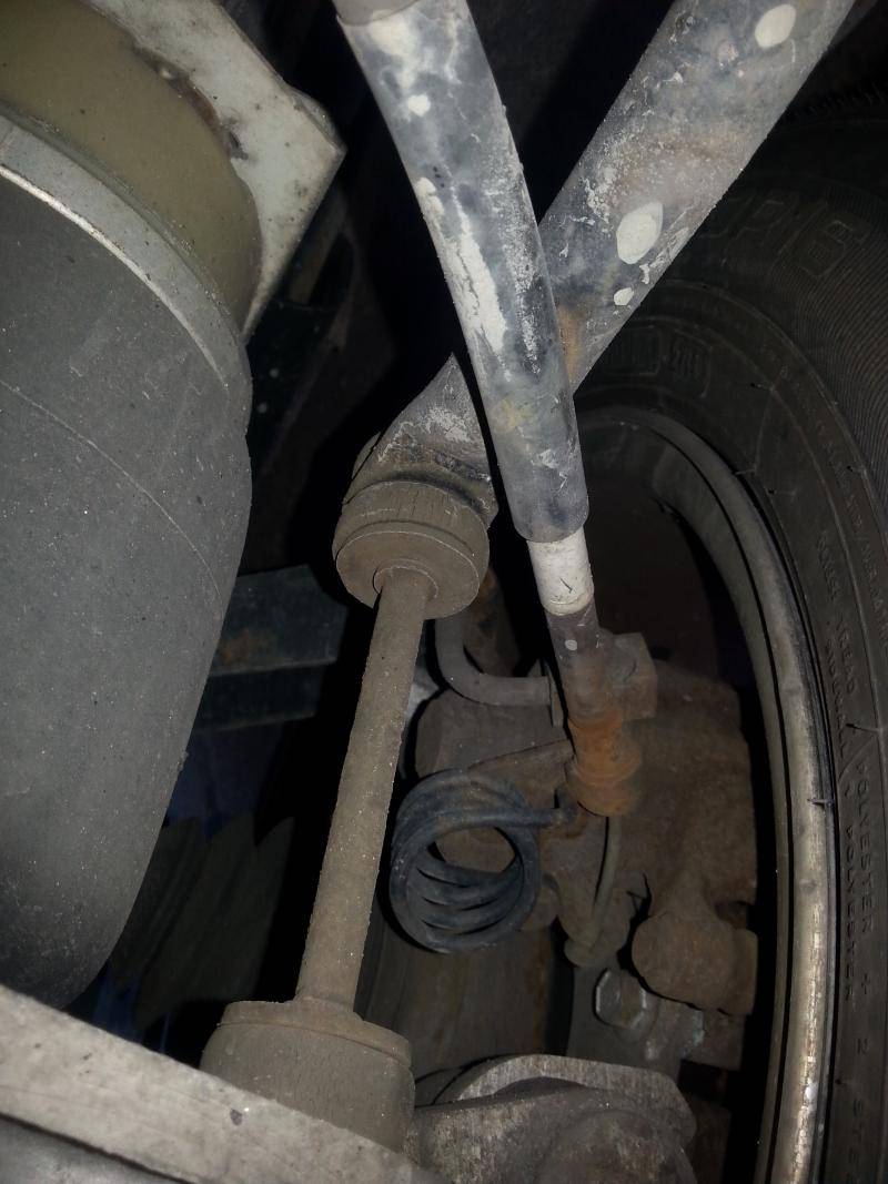

While down there, I think I spotted something that may contribute to the noise I've been hearing as of late.
Rear Driver
Rear Passenger
I could be mistaken, but I think that doohickey on the driver's side is supposed to go into that rack/bar/bracket thingymajig.....
yeah , you need upper shock mounts and sway bar end link bushings
Yeah, half the sway bar link missing might have something to do with it.

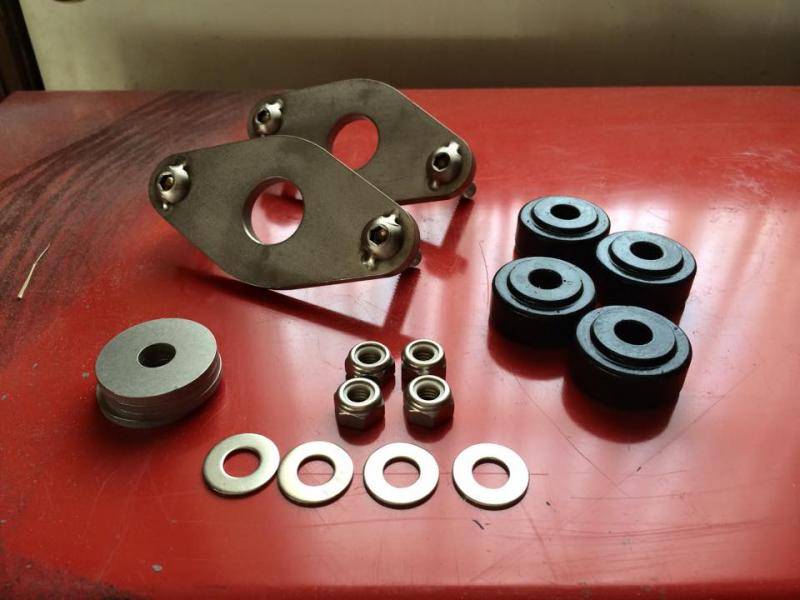

Scallywag, I've got the shock mounts in stock and ready to go. PM me if you'd like to order a set. Those stock ones are definitely shot! I would recommend installing new shocks at the same time. You can use any 89-97 Thunderbird shock, or any 99-04 (IRS-equipped) Cobra shock.
If you're looking for factory ride quality, I'd recommend the Monroe Sensatrac 5965, and for a more performance-oriented shock, I'd recommend the 03-04 Cobra Bilsteins. The Monroe's are also your most economical option and go for about $20 each on RockAuto.com.
The shock mounts are $66 shipped, and are 100% stainless steel construction, including all fasteners and washers, and include Energy Suspension poly bushings.
See pic below:

Sure. Jay.richmond(at)gmx.com
Let me know what shocks you'll be using since some of them need different sized washer/bushing holes.

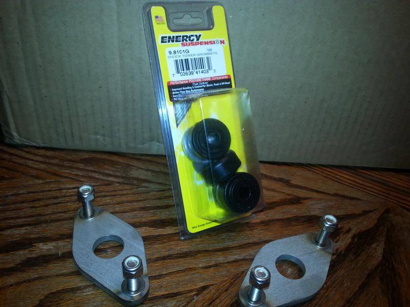

These came in earlier in the week. :)
Very solid and sturdy feel !! I'm sure they'll do great once I receive the shocks, which I haven't just yet. I just hope it's as easy as it seems.
