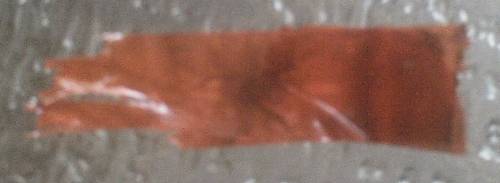

I was under the car and spotted this piece of tape across the bottom of the Coil Spring. Is this put on at the factory? If so, it's confirmed that my current setup is indeed, 149k miles old.
Looking at images of used Rear Shocks on Google and what do I see? That little piece of orange tape! Yeah, my Rear Shocks are toast - and factory installed.
