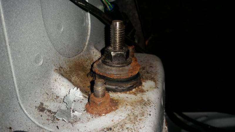

I've noticed this for some time and it was very slight, so I wasn't concerned about it.
I'm pretty sure it is the upper shock mounts. My question is can the M8 still be driven till I get the new mounts or can this damage anything else. To me it looks as if the metal frame is coming up near the mount bolt. See below. The rust is only on the left side.

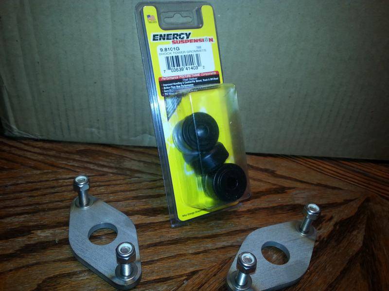

Which are best? I found these https://www.supercoupeperformance.com/rear-poly-shock-mount-kit-for-non-arc-shocks-502
But they do not much look like the stock mount to me.

I dont remember the part number but I used the Ford Part number on ebay and got 2 new Ford shock mounts for $30, you can also look for universal shock bushings and burn the old ones out of the housing... The ones at SCP are a little over priced and wont fit over the stock 93-94 electronic shocks. Im not sure if they fit others... When I called to complain he said I either have to drill out the metal sleeve or buy shocks from him....

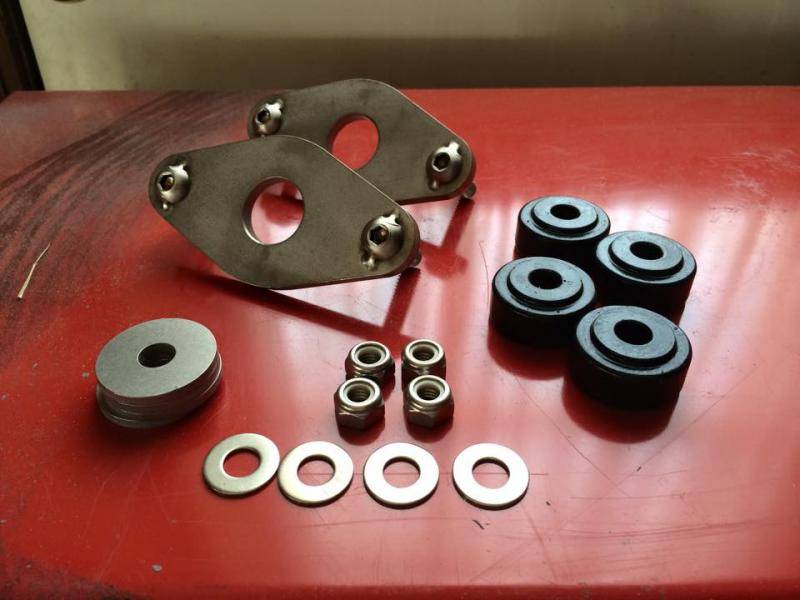

Here is what he offers.
Here is how I received them.
Excellent quality thus very reliable, fair price and ready to accept your new struts!

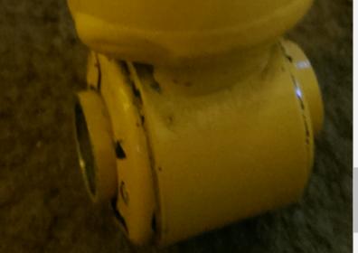

I wasn't referring to the washer, I was speaking of the bottom of the shock pic when I zoomed it in. Here is how it looked on my PC. In my actual pic (much bigger) it looks a lot like rust, is it just dirt?

That's painted rubber. It breaks down a bit when you tighten the bolt. It's rubber the black stuff.

Thanks for the update re: bottom of shocks.
