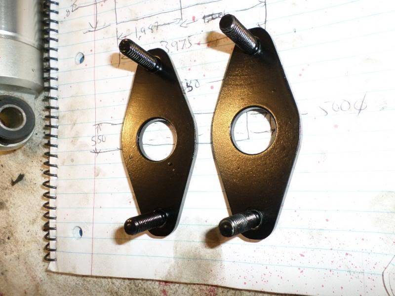

Was very happy when I replaced the Qa1(HAL) single adj rear shocks on the green stang with double adj Koni coil overs. The single adj shocks where a perfect fit in the mk8. I was going to try to make them coilovers but there is no room in a mk8 for that with shock in stock location. I will be making spring jackers so I can adj ride height out back. Of course I could not just pull out stock shocks and install new ones. LOL Top shock mounts where toast so I had to make those. To bad I don't have a water jet like some people. (nudge nudge wink wink)

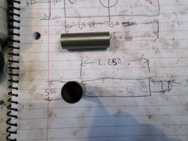

I had to reduce the lower shock mount bolt to 1/2 from 14mm so made these sleeves, so no crazy slop.

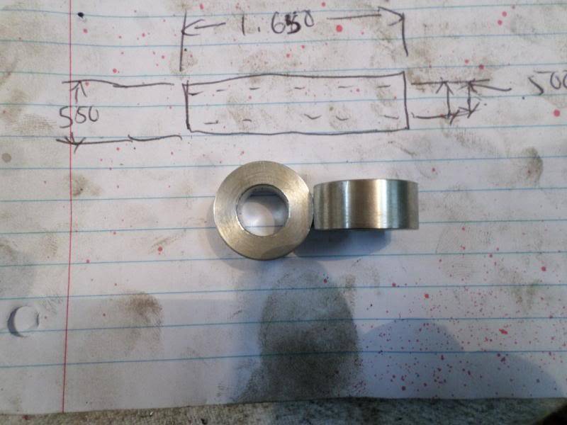

Also needed to make these spacers to keep shock from hitting lower control arm.

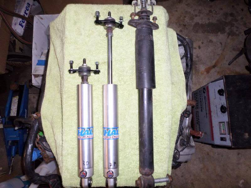

Here is old with new.

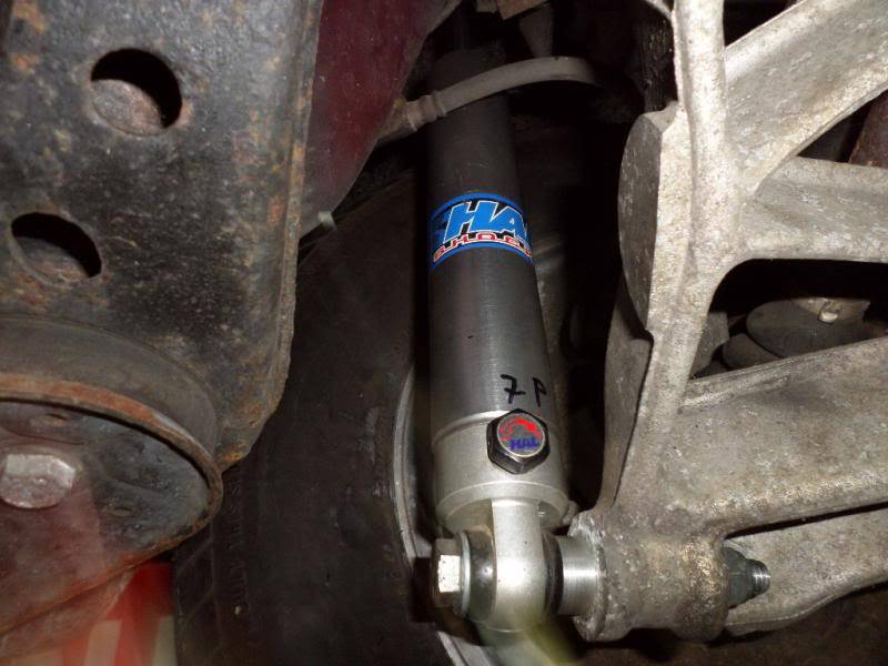

In the car done.
