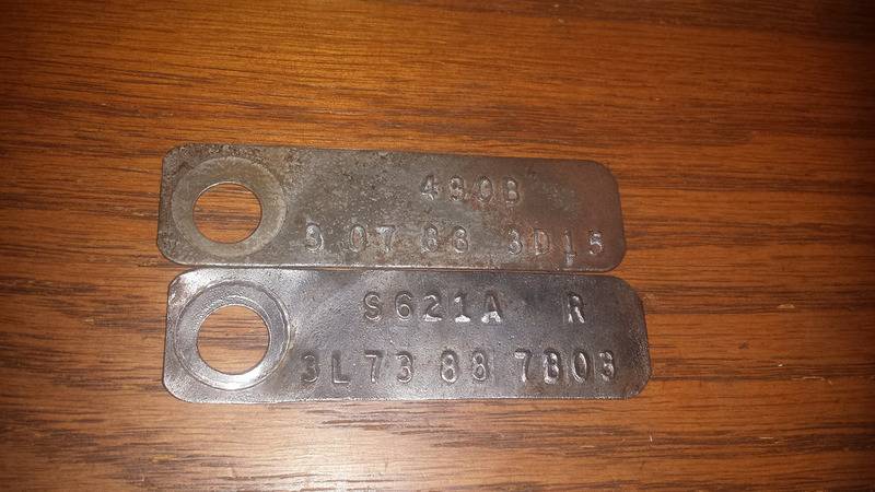

diff tag bolted to one of the cover bolts.
these are 8.8 tags, but the principal stands.
2015-04-02 22.53.30 by chris2523, on Flickr
3 07 is a 3.07 open diff.
3L73 is a 3.73 track lock diff.
you wont find an LS diff with a track lock, but now you know what the tags look like.
