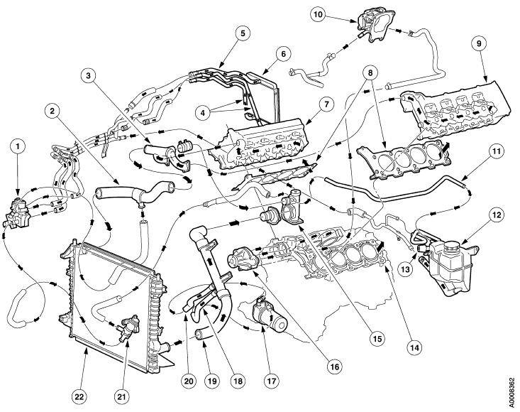

I had a similiar issue last month on my 2006 V8 and in the end, it was a cracked piece of plastic at the "T" on the upper radiator hose (see #2 in pic).
It would stay sealed for a week at a time, and then, all of a sudden, open up to enable to car to overhead almost immediately.
A leak test (as suggested) would hopefully help you to find any leak. So much plastic, so much that could crack.
