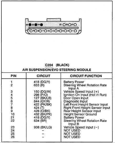

So I want the car to stay the same height no matter what, where, when, how. I am going to sensor-lower it as well.
Judging from the diagram below, all I'd have to do is cut #5 to the module won't know that the door is open/closed.. am I right? Or would I need to supply current to it at all times so it WILL think that the door is open?

dont think that will work.
as i believe having the door open will stop any change at all, so no load leveling either. in which case, just turn the switch off.
if you want to stop the drop on the highway, cut the VSS wire.

The air ride system doesn't work like that at all. You cut any wire and you'll just make the thing throw a fault code and not work at all.
Also that seems like a huge huge waste of a working air ride system. If you just want one ride height then go to coils.

no, shutting off the door stuff will still leave the speed related drop.
this is not going to achieve "the same height at all times."
the ASHAM does not tie into the VSS wire. it can not turn off the speed related raise or drop.
what it can turn off is the "park height" drop.

i still think you can stop the speed related drop by unhooking the VSS wire. then you stay in "city height" at all times, which you can sensor lower to wherever you want.
also i see this whole exercise as pointless.
the air ride handles everything perfectly fine as designed.

Don't be so Negative Nancy, Chris! I like your idea. After looking at the schematic, you're spot on.
he wants to keep load leveling though. (i think anyway)
Yes siree. I want "partial" control of the air ride system - but I don't want to have to press buttons every time I load the car with something heavy or have passengers. The main point to all this is just to keep the car at the same height at most times (while sensor-lowered). At the same token, the system won't have to keep running the compressor so much that it'll wear faster. I see more pro's than con's.
