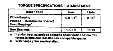

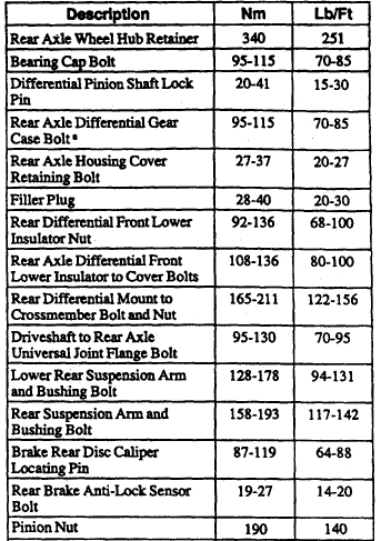

Hopefully this will help and hopefully I downloaded the correct file. wrong pic sorry retry.
Thanks for the info!
