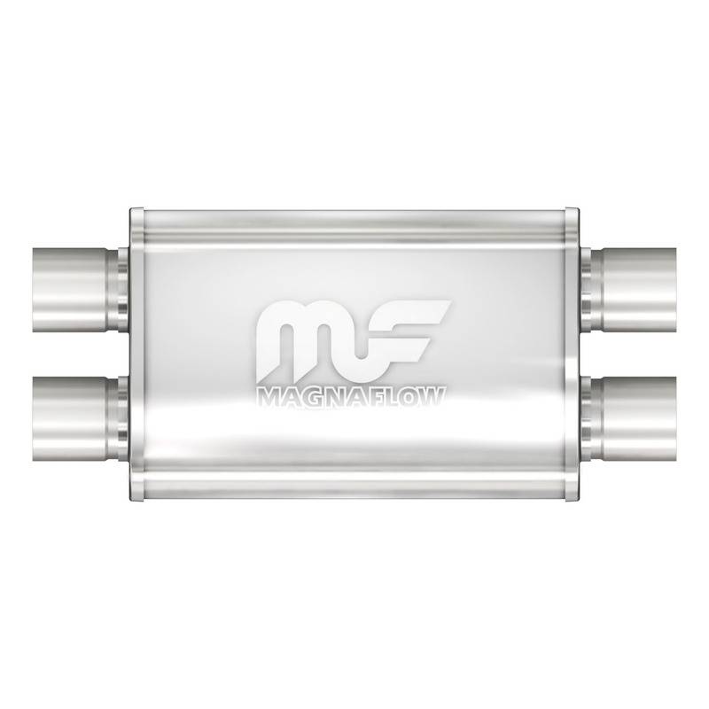

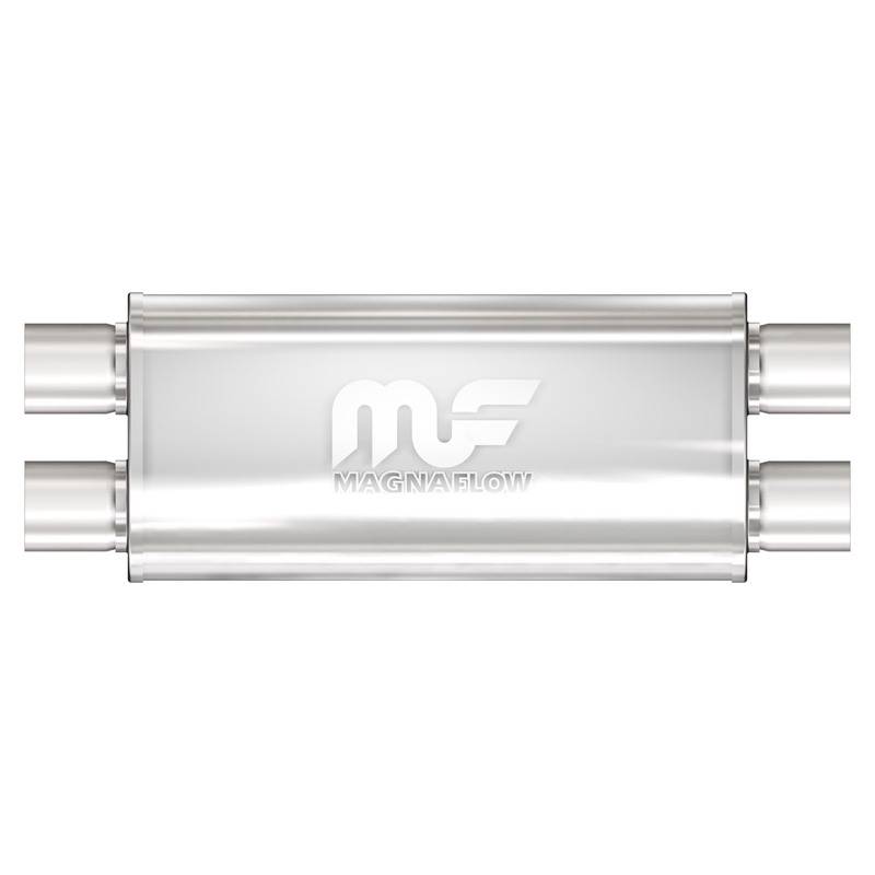

you can use a dual in/out in place of the resonator. I originally had one and it was too big and my car is lowered so it would hit. That was a magnaflow 5" thick body dual in/out and I think 18" long that had a built in x-pipe, this one,
http://www.magnaflow.com/02product/shopexd.asp?zone=main&id=9060
So I then got a smaller one which was on Tommy's car (NYCLS8) which was a 4" thick body and I think 11 " shell and fits perfect, does not have the built in x though so I also added a x-pipe, I dont see the one I have on magnaflows web site anymore, I thought it was 4" by 8" body the one I have but I do see this one in 4" X 9" with a built in x-pipe,
http://www.magnaflow.com/02product/shopexd.asp?zone=main&id=9018
Dont mind the prices listed, they can be found for less and are available as polished stainless or regular stainless.

Nick thanks for the first hand information. I do plan on lowering it so the 4x9 option sounds like a good plan. I already have an x-pipe so thats not to big of an issue. I'd just like to have resonators in there somewhere to quiet it down.
